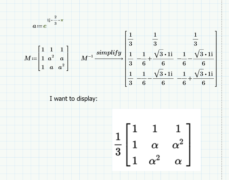

How can I simplify Matrix Inversion

No, that doesn't work, you'll get something like:
So:
I wouldn't know of a way to get the 1/3 before the matrix.
However in all cases you should realize that it is very hard to drive the results of the symbolic processor in any direction.

Try undefining  a before the symbolic operation.
With a known to the symbolic processor, any symbolic operation will never result in an expression containing a itself, but use its definition instead.

LucMeekes‌ Close enough!
