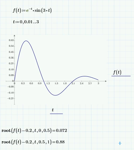

Hello. I have the following function:
There are two intervals above 0 in which the value of the function is bigger than 0.2.
How can I get those intervals?
Thanks!

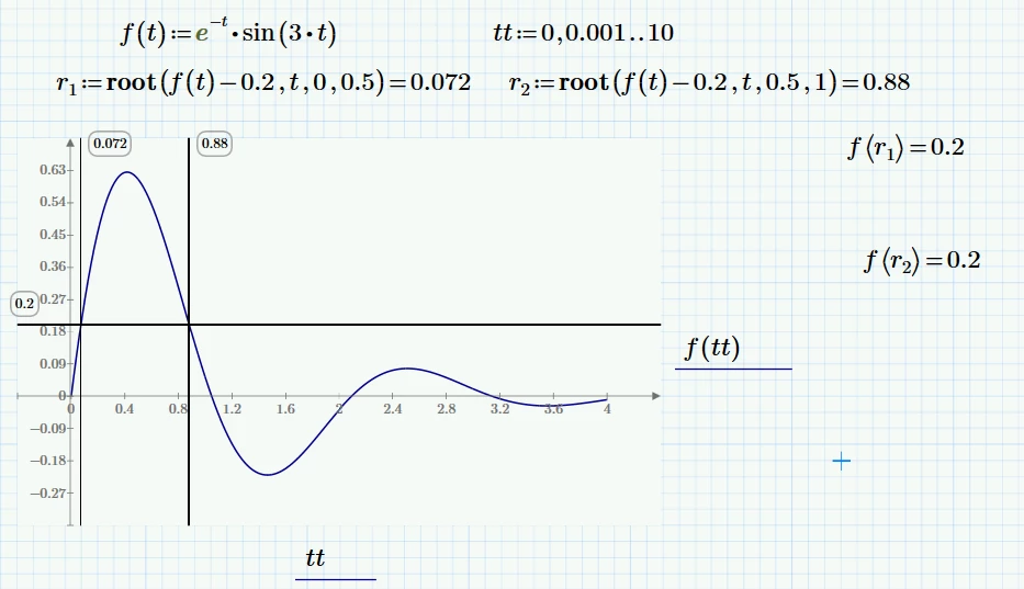

23-Emerald V
May 7, 2018
There is ONE interval where the value of the function is above 0.2.
The start and end points of that interval as found as follows:

Lksfnd1-VisitorAuthor
May 7, 2018
Oh yeah, I made a mistake describing my function. I wanted the intervals where it's either above 0.2 or below -0.2. But you already answered my question, thanks!
