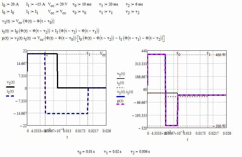

You could try this way (but note that symbolics don't recognise units):
Alan

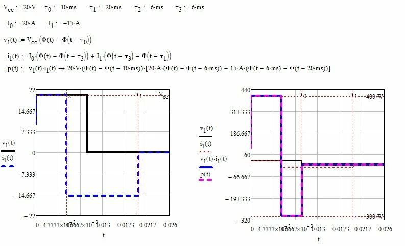

April 14, 2021
