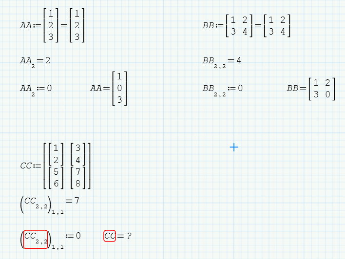

How can you define an element in a nested array?
I can define an element in AA.
I can define and element in BB.
Am I doing something wrong with CC? Or is Mathcad not capable of this? Is this a typical problem and does anyone know of a workaround?

You are not doing anything wrong, Mathcad is. We have requested this be fixed for many years (much longer that PTC has even owned Mathcad). It (like so many other requests) has gone nowhere.

Best I can do for you:
You could also turn this into a function:

The function approach should work. Thank you.
It's a shame Mathcad can't handle this. Makes things messy.

Only with Mathcad PM:
Define an element in a nested array

This doesn't seem to work if the array already exists.
December 1, 2016
Mathcad PM is Valery's vision of Mathcad. It does not actually exist.
