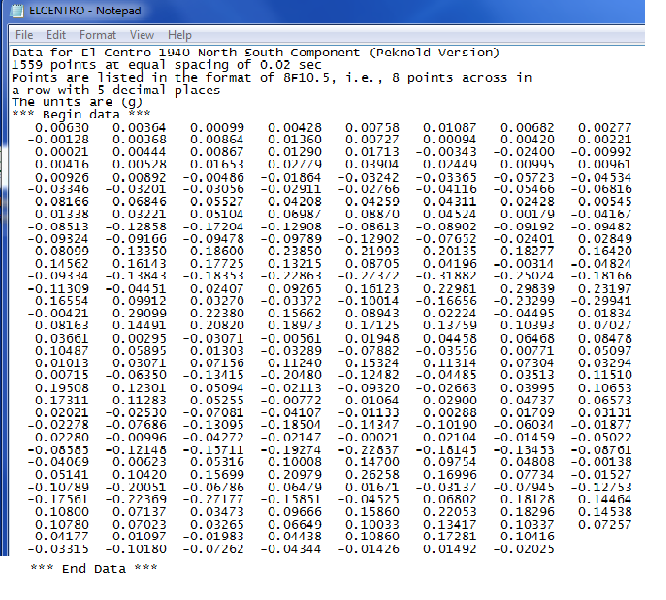

I have the ground motion data in txt file as follows: I want to escape the the text from the first 6 rows and text from the last row. Finally I need a vector escaping all text in this txt file.
Could you help me how can I do it?
Thank you very much.
Dec 18, 2014 8:38 PM UTC
Keshab
Go to insert>component>import wizard and choose delimited text. then put the file name by browsing it. The wizard will
ask you for the row number. In your file the data begins at row 7. If you wish to give the range of columns you can. after you are done you will have to give a name to this data. If you send me the data file, I can send you a mathcad file for it.
