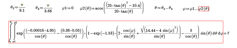

How could i solve this equation numerically if the Phi value is dependent on Theta?
have a problem in solving a numerical double integration, two variables dependent on each other, the boundary for one of them is known, but the other is not.
tried to sole it in mathcad but i think that there is an error in inputs, or how to put it in mathcad in the right mannerPTC+mathcad.png

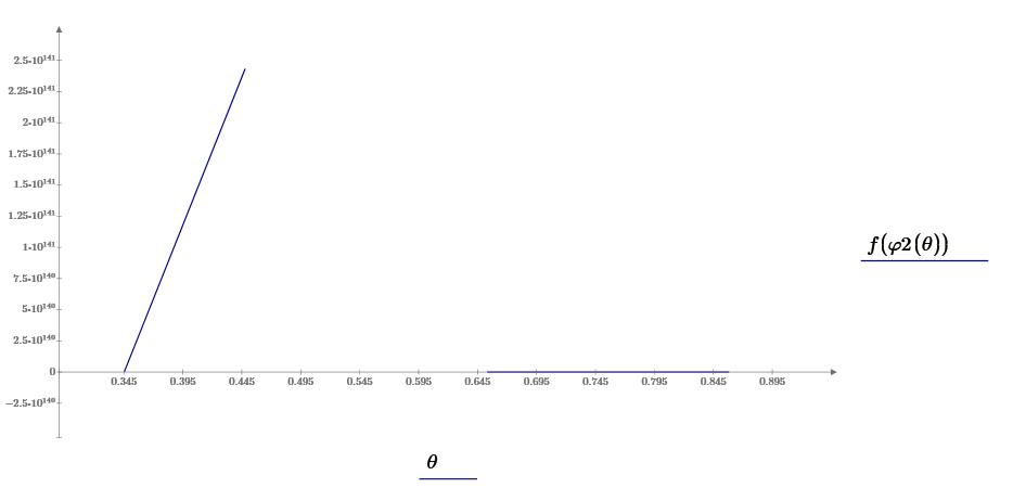

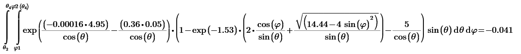

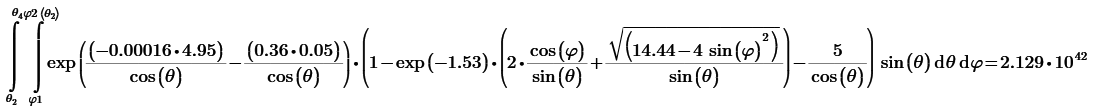

Did you just want these:
and
Or also values in between:
with:
plots as:
Sucess!
Careful, attached file is in Prime 4, you need prime 4 to read it!

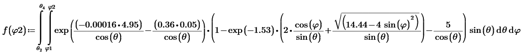

Mar 30, 2017 3:54 PM UTC
I think the attached file does what you want.
Your integral evaluates to a single value.
File is Prime 3.0

but why you replace phi in the equation by s, the value of this equation is unit-less, my target is not to calculate phi, but a unit-less value depend on both theta and phi, so is that possible?
23-Emerald I
Mar 31, 2017 11:35 AM UTC
"s" is a variable of integration.
Attached file has a bit of explanation, I hope it helps.
