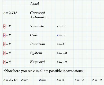

As Fred notes, depending on how you label, or tag, e, you can have different symbols e, all with a different value at the same time. Note that you can do this in Prime:

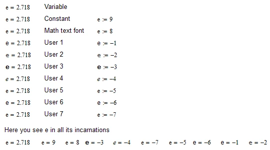

as well as in (real) Mathcad:
Which e do you like best?
If you like a mess, you can have all e's look the same, by defining the same appearance for all labels and tags.
It's interesting to see that Prime knows e as 2.7... only when it's a constant, so you can easily have a variable e with a different value. On the other hand Mathcad (11) knows e as 2.7... independent of its tag, but you can redefine them and they will keep their value.
