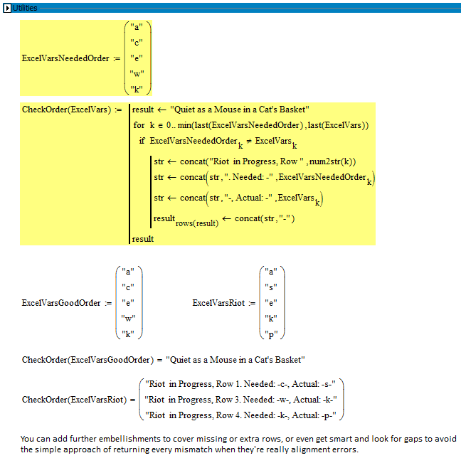

For a lengthy calculation I'd like to read in parameters from excel. As this excel sheet is lenghty as well I want to check first whether the parameters in the Excel sheet match the parameters in my MatchCad sheet (naming and order of parameters). I'm thinking along the lines of making a one-to-one comparison of variable names (not the variable values!) in order to verify a match.
Does anybody has an idea how to conduct such a comparison?

How about using an array with the variable names in and iterating through that?  You could hide it in a collapsed Area once you've got it debugged and just set a variable to give you the result of the check (eg, a simple "OK" if everything's OK or a list of variables that aren't playing nicely).  That is, something along the lines of:
Stuart

Thank you Stuart.
Neat idea, but then I do need to define the parameters twice. Once as a variable and once as a string for performing a check as you proposed it. This is error prone therefore I'd like to use only the variable names. Perhaps some nifty VB code does the trick?

Errare Humane Est.   The most obvious way to do that would seem to be to get the Excel array of variable names and pass it to the VBScript.  Then iterate through the Math regions until you find variable names you want (I don't know how you guarantee that there are no other variables (such as index variables) or how you would identify them (Tagging them is an option, but then you've got an error-prone maintenance task if you need to change the structure of the worksheet).  An alternative, but vary much along the same lines, is to use a file read function to hunt for the corresponding variable definition xml strings in the worksheet's source code.
Of course, there could be a mistake in any code that misses certain cases!
Stuart
