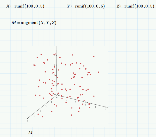

You should be able to do a 3D scatter plot

Contourplot means that you have a surface, but your list just represents a bunch of single, not connected points. To represent a surface we would need a mesh structure, need the information which points should be connected, which points form a facette of the surface.
While Prime sure is not the right tool for 3D or contourplots, you may try to fit a surface to your points an use this for a contour plot.

Thanks, gentlemen. It was the "augment" function I was missing. Basically, I just defined the z-axis as
:= "augment("x-axis column label", "y-axis column label", "z-axis column label")
aaaaand BOOM. Pretty contour plot. Problem solved.
