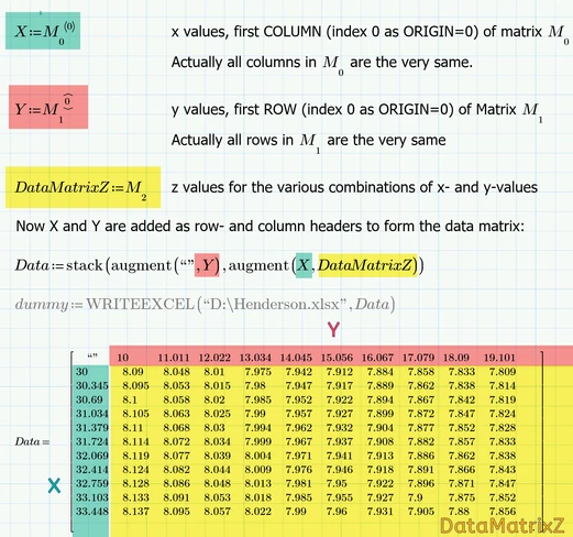

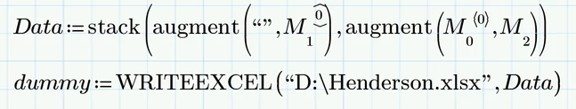

The data structure suggested by Terry can be easily created in Prime and then exported to Excel in one go:

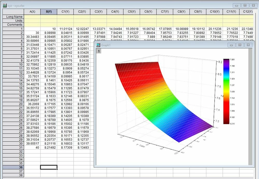

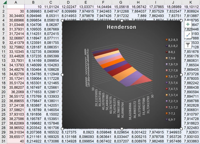

And you may even create the plot in Excel but it would need some more additional work to have it using a better color scheme and more meaningful scales.

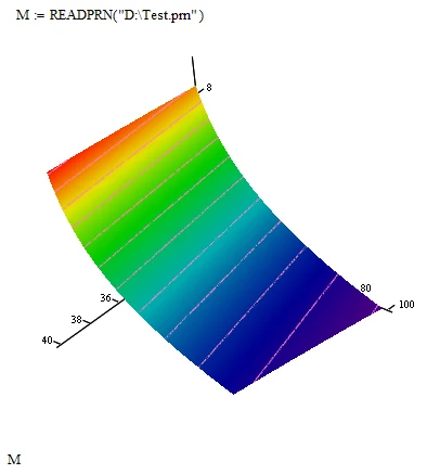

Which data structure is needed by the external graphics program?
CreateMesh creates a nested matrix. Its a 3 x 1 matrix and the elements are n x m matrices with the x, y and z values of the surface points. Furthermore this structure also defines automatically the quadrilateral "patches" the surface consists of.

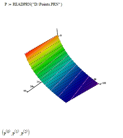

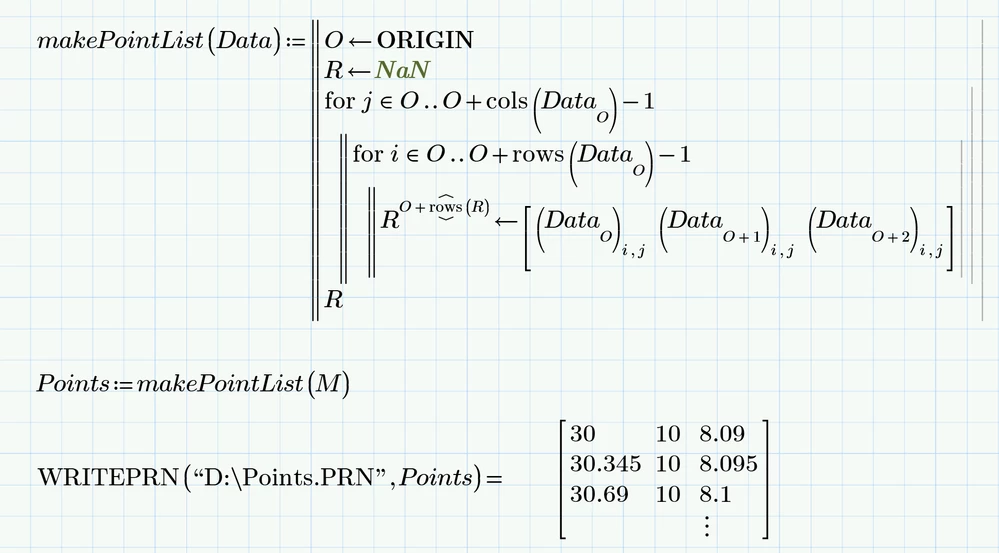

It would be easy to write a small program to export a 3-column matrix with n * m elements consisting of all the points of the surface, but how would an external program know which four points create a side face of the surface?
So once you know the data structure needed for your external program, it may be possible to write a Mathcad program to create and export that structure.
I guess most programs won't understand the structure READPRN creates
Real Mathcad of course does:
Real Mathcad even makes a good job if only provided a simple linear point list without any information about side faces.
In Prime:
In Mathcad
But again - you'll have to know which data structure your external program needs.
terryhendicott
Export the three nested matrices in M as separate Excel files.
Most graphical packages can handle Excel files.
For example ORIGIN with a simple rearrangement in Excel gets this:

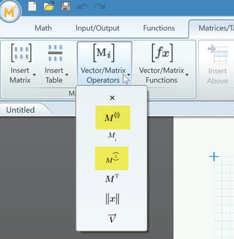

Werner,
Please explain the matrix operators which have vertical and horizontal parenthesis. Thanks!
Glen
@gatlas wrote:
Werner,
Glen
What you are referring to are the matrix row- and column selectors.
https://support.ptc.com/help/mathcad/r6.0/en/index.html#page/PTC_Mathcad_Help%2Frow_and_column_operators.html%23
Here is in a bit more detail explained what I did:
So, if the program you use for plotting expects that kind of data table and if it can read Excel (which is very likely) this should help.
Prime 6 sheet attached
