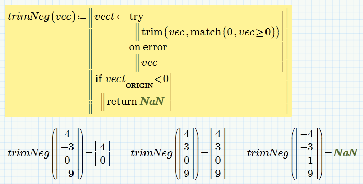

For completeness sake here the Prime version
The basic line (first one in my answer above) will work in Prime Express, too, but for the error catching you need the full version because "try" is a programming command and programming is considered a premium feature which is not enabled in the free Express variant.
EDIT: Just found that the "trim" command is also considered a premium feature, so not even the basic line won't work in Express

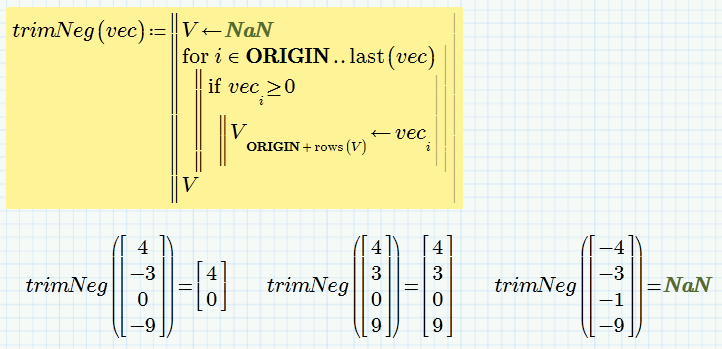

And just for fun here is an alternative, classic approach, going through the vector element by element and collecting the appropriate elements for the new, trimmed vector
WE
