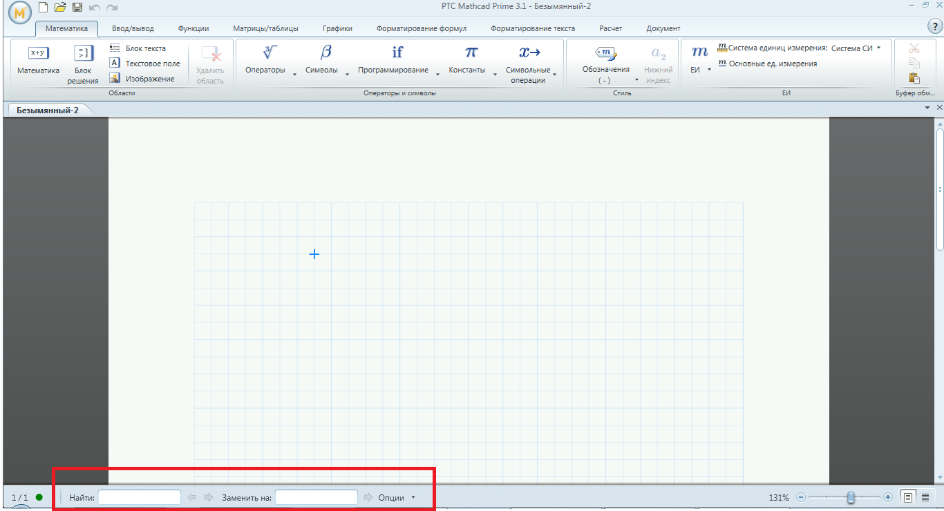

How do I FIND and REPLACE in prime 3.1 (What are the key strokes?)
How do I  FIND and REPLACE in prime 3.1  (What are the key strokes?). I want to use find and replace variables in Prime. Where is this functionality?
LucMeekesAnswer
23-Emerald V
November 9, 2016
It's [CTRL-F] (as usual) and then you find the search and replace input boxes at the bottom of your Prime window.
LucMeekes23-Emerald VAnswer
23-Emerald V
November 9, 2016
November 10, 2016
You can also find this option at the bottom of the document.
