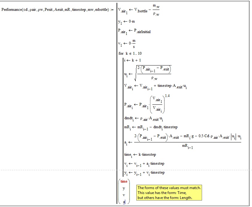

How do I get rid of "The forms of these values must match" error?

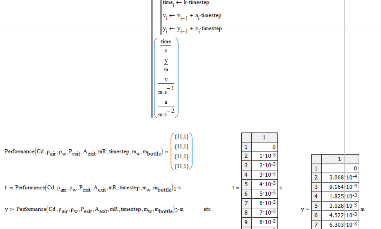

I get the error noted at the bottom. How do I resolve the error message below? I've attached my MathCAD file. Thanks-
RaikoAnswer
February 25, 2015
Hello Eunice,
MathCad 15 doesn't like to mix units in an array, so it is best to get rid of them. I took the liberty to edit your document. I hope it shows how to procede.
You might also to distribute the calculations over separate functions - then you could keep the units.
Raiko
