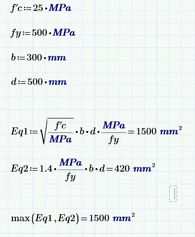

I need the maximun of these two values.
These formulas represent the maximun reinforcement bar.
March 7, 2019
That is only possible if
 f ' c
is unitless.
Otherwise, as explained, it's nonsense.
Where is the worksheet...?
March 7, 2019
Here is a worksheet.
Yabo1-VisitorAuthor
March 7, 2019
Thanks bro! Have nice day.
