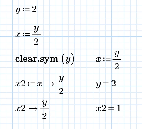

ttokoroAnswer
Jan 10, 2023 1:41 AM UTC
t.t.

I don't have a clean sheet to post. To clarify I just restate the formula when I set it equal to a new variable. (see example below)
y:= 2
x:=y/2=1
V   (one eternity of pages later.......)
x2:=x=y/2
The bold is what I want to see in addition to just saying x2:=x. It's just so that I can quickly verify that x2 is based on the same formula as x without having to go search for x.

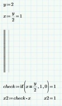

terryhendicott
Jan 9, 2023 10:44 PM UTC
Here is one way to check. true is 1, false is 0 in Prime
