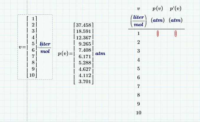

How do I move matrices into table?
How do I move the two matrices from the right into the table (not manually type)?

Cannot tell much from a picture. Please post the worksheet.
As far as I'm aware, you can't.  The table is only meant for input.  You could send the data to an Excel component (although I don't know how it will handle units).  Alternatively, you could write a short program to augment the vectors and add title information - it won't look as good as a table, though.
Stuart
October 27, 2015
You are correct Stuart. Mathcad tables cannot accept pre-defined variables, which is a shame and a improvement I have recommended on several occasions.

I am sure it will convert the units relative to base SI. I have tried changing the unit system, but the Excel component still coverts relative to SI.
