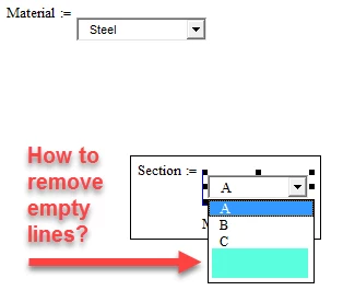

How do I remove empty rows from a drop-down menu?
How do I remove empty rows at the end of the second drop-down menu when selecting "steel" in the first drop-down menu?
Werner_EAnswer
Jan 26, 2026 3:11 PM UTC
You could use "ReDim" to redimension variable "Section".
Sub ComboBoxEvent_Start()
Material= Worksheet.GetValue("Material")
If Material= "Cast Iron" Then
 Dim Section(2)
 Section(0) = "1"
 Section(1) = "2"
 Section(2) = "3"
ElseIf Material= "Steel" Then
 ReDim Section(2)
 Section(0) = "A"
 Section(1) = "B"
 Section(2) = "C"
Else
 ReDim Section(4)
 Section(0) = "A1"
 Section(1) = "B2"
 Section(2) = "C3"
 Section(3) = "D3"
 Section(4) = "E3"
End If
ComboBox.List() = Section
End Sub

Jan 26, 2026 4:01 PM UTC
Thank you very much!
