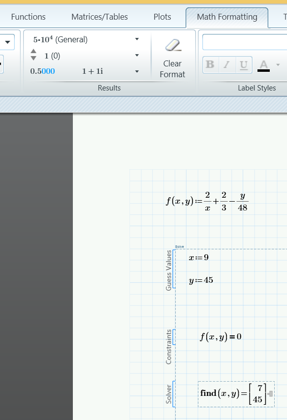

How do I set constraints to whole numbers
RichardJAnswer
It is not possible to constrain a solve block to integer solutions.

Could you change the default setting showing 3 decimal places to 0?

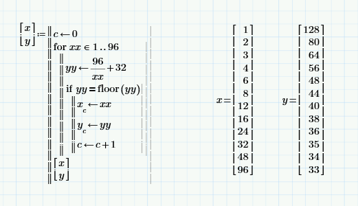

There are several solutions.  Assuming positive integer solutions only:

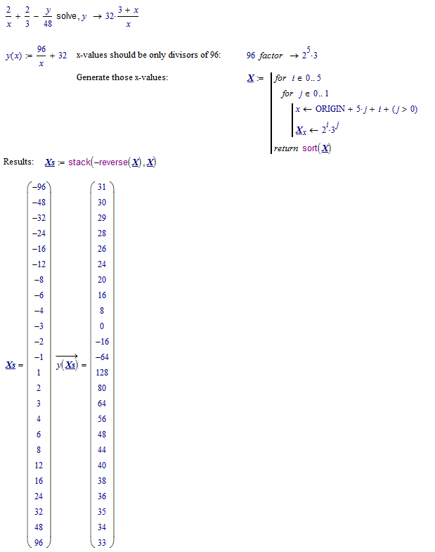

RichardJ19-TanzaniteAnswer

Taking all the above knowledge together:
