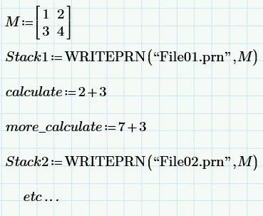

terryhendicott
Jun 8, 2022 4:42 AM UTC
Pepper the file with WRITEPRN statements altering the file name in a sensible fashion.
Prime will write the files until something crashes then you know what is causing the problem.
Cheers
Terry
