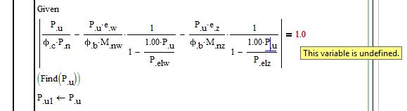

How do I use a solve box with range variables?
I have a series of equations to solve with range variables but I get a "This variable is undefined." error when using the Given/Find solve boxCapture.JPG
I have attached the Test worksheet and the original worksheet that demonstrates it works for a single variable
23-Emerald I
You can't put solve blocks into a program block. You CAN define a function that runs a solve block and put that function into a program.

The solve block has been re-configured as a function, all inputs listed as parameters.
The sheet will work over a limited range of your input spread-sheet data, but if you try to run it over the whole set it still crashes.
Either there is still a problem with the method that I haven't seen - you will need to try spot checks against your single sheet.
Or there is a problem with the input data.
Either way , it is beyond my knowledge & I'll leave it up to you to fix.
