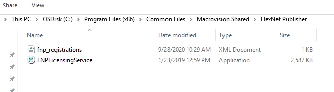

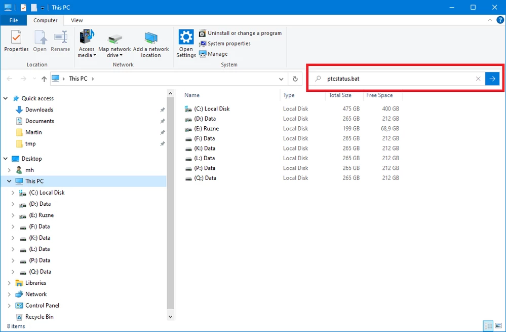

November 8, 2022
I don’t see the file ptcstatus.bat
Please advise where else I can try?
Phillip

1.] Verify whether your license is floating one.
License file must contain two lines similar to following ones:
SERVER __HOSTNAME__ PTC_HOSTID=00-11-22-33-44-55 7788
DAEMON ptc_d __PTCD_PATH__
2.] Search whole disk C: for ptcstatus.bat
3.] By default current version of FLEXnet is installed in C:\Program Files\PTC\FLEXnet Admin License Server directory.
ptcstatus.bat is located in bin subdirectory.
