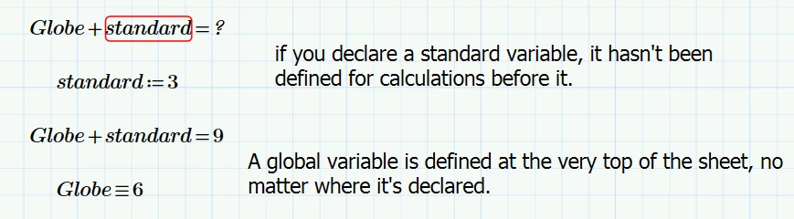

One option would be to make the variable S a global variable. But that is a PITA because it ripples down to all variables needed to calculate S: they must be global as well (Don't know if Prime supports globals at all.).
The other option is to put your appendix in a separate file, that you reference at the beginning of your (main) worksheet, or at least before you need to display S's value. In that way no globals are required.

A global variable (available as an operator in Prime) is a three-line equals sign.  When you define it, it becomes available for calculation anywhere in the sheet, no matter where on the sheet you define it.  I like Luc's other suggestion better.
