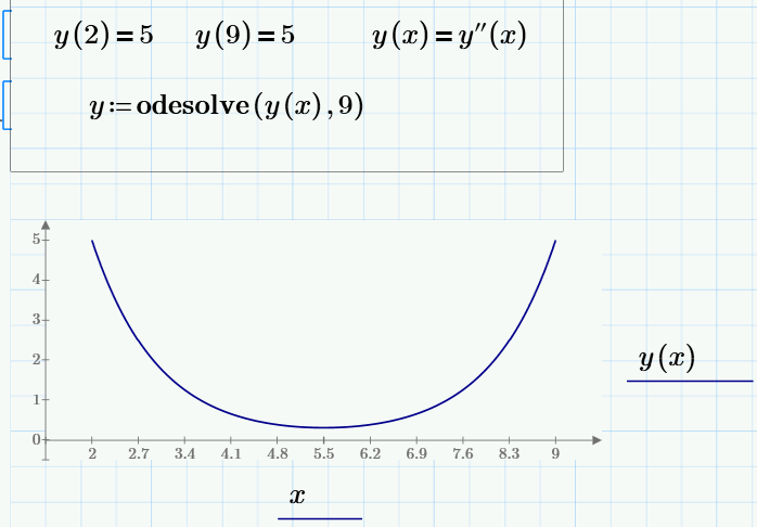

How do you solve a boundary value problem in mathcad prime 3.0 with a solve block?
How  do you solve a boundary value problem in mathcad prime 3.0 with a solve block?  I have been wondering about this for a long time because I want to use it to solve Schrodinger's Equation. Can it even solve BV problems if there is not a unique solution?

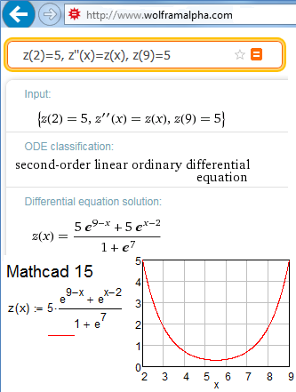

A symbolic solution
Mathcad 15
One picture on my office wall:
