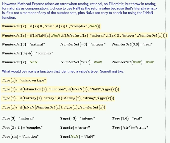

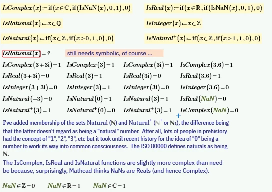

Whilst playing around with the Is Element Of operator in Mathcad Express 7, I noticed the following:
I was surprised to see that Mathcad thinks that NaN is a Real (and hence Complex), but not an integer.
Is this just a case where one should expect inconsistent results from applying non-NaN-specific functions to a NaN?  If so, I think there should be a warning about this behaviour on the Is Element Of Help page.
Or is it something that should be corrected?
The red error arises because only the symbolic processor can test for rationals and Mathcad Express doesn't have symbolics.  Consequently, I don't know whether Is Element Of's NaN behaviour extends to symbolics.
Stuart
I discovered the above whilst trying to write a couple of data type identification functions.

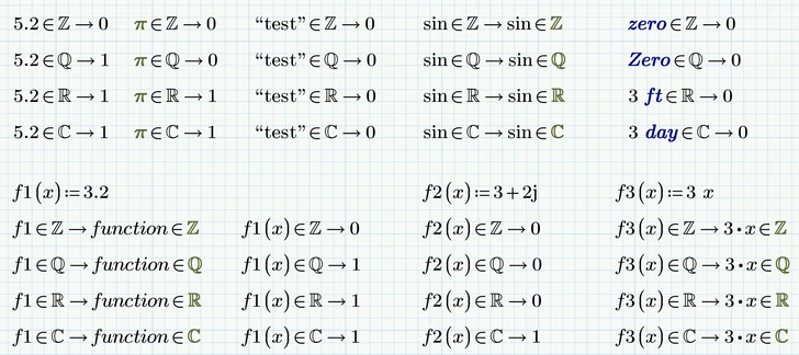

Here is how the symbolic processor treats NaN (done in Prime 6) for your information
The symbolic processor just returns the expression unevaluated?  Strange, I wasn't expecting that.  How does it evaluate integer, rational, real & complex numbers and strings & functions?
Stuart
November 22, 2021
Yes, it treats NaN like an unknown variable. There is no difference whether "units/constants in symbolics" is turned on (like in the screenshot) or turned off.
According to numbers the result is as expected, strings are not seen as numbers as it should be and functions ... see yourself. The function name alone is simplifed to "function", otherwise the function is evaluated and we get a result only if its a constant number
The "assume" modifier is ignored
