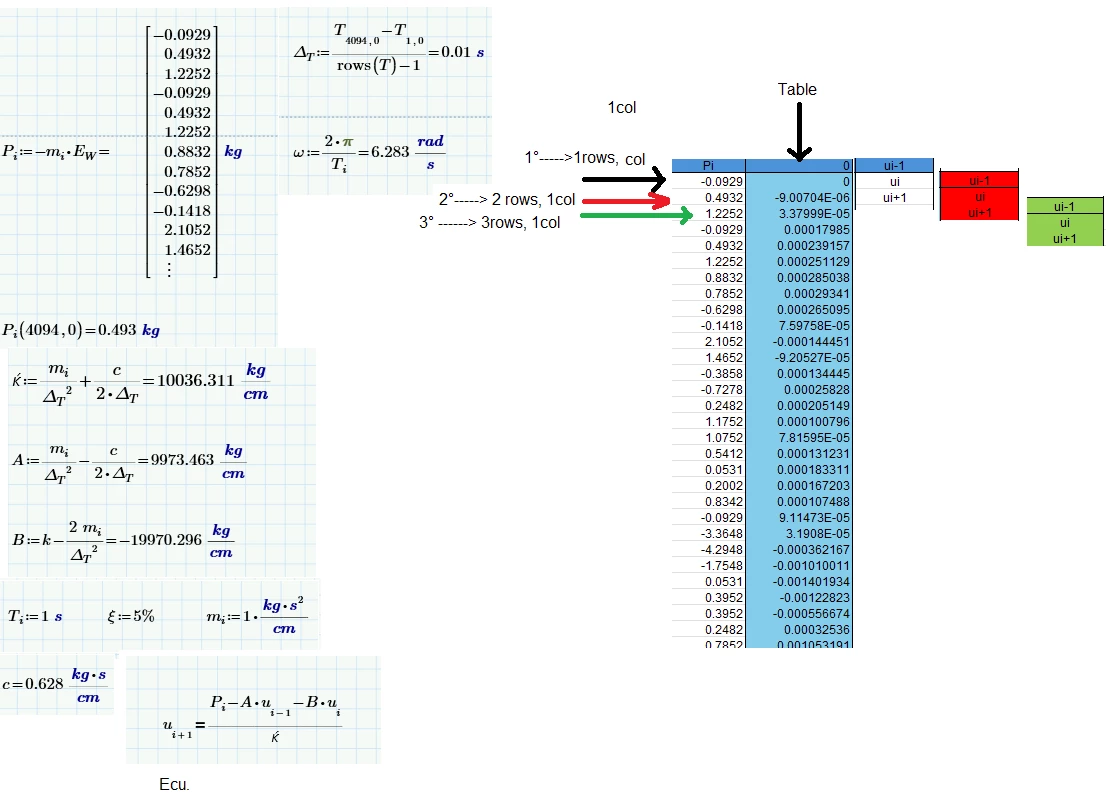

How generate a cumulative sum sequence funtions
i Have PTC MATHCAD PRIME
 need a function to generate a cumulative sum sequence where Ui=0 and Ui-1 =0, iteratively calculating Ui+1 up to a 4094 rows , 1column vector.

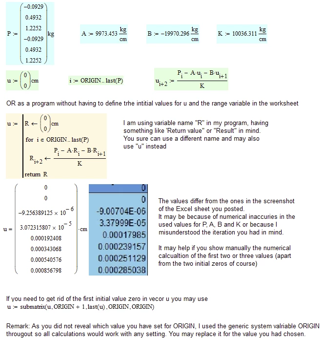

Werner_EAnswer
Aug 18, 2026 12:22 AM UTC
Here is how I interpreted the iteration in your question. But the results differ from the ones you posted so it may help if you show step by step how to arrive at -9.00704*10^-6 and 3.37999*10^-5 using the values for P, A, B and K shown in your screenshot.:
9 replies
Werner_E25-Diamond IAnswer

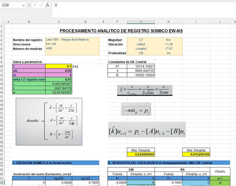

pannus010-MarbleAuthor
Aug 18, 2026 5:54 PM UTC
here ist’s
It starts with 0, assumed initial value
second rows:
third
and so on until completing 4094 rows, because "origin=0"

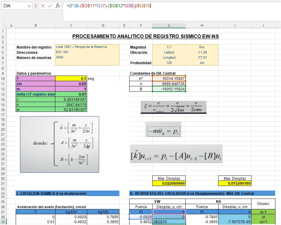

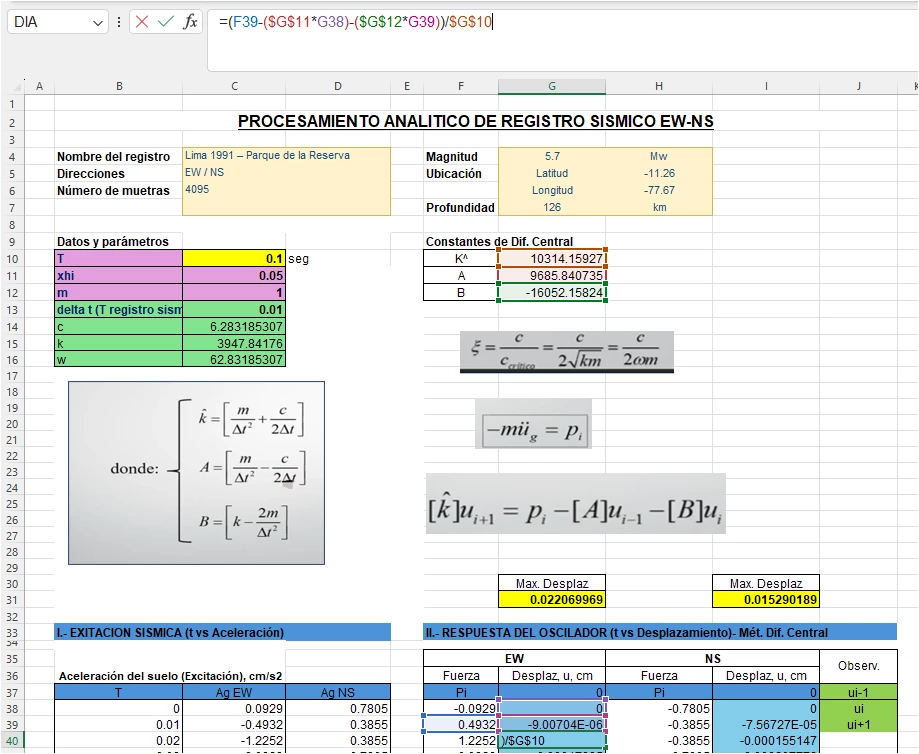

Aug 18, 2026 9:55 PM UTC
I don’t care about and will not look at just pictures(!) from an Excel sheet.
What I meant was that you show in Mathcad or Prime how to arrive at the first two non-zero values in vector u which you show in your first Excel screenshot by using just the numbers for P, A, B and K which you show in your first screenshot. I mean using the numbers with just the precision you had shown and which I  also used in my screenshot.
Simply show the manual calculation in Mathcad/Prime, the first two iteration steps, which you have in mind and show that you arrive at the values you has shown.

There is a more fundamental problem:
Units problem

Aug 19, 2026 7:05 AM UTC
Apologies, my mistake, the units are the same.
