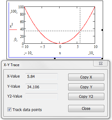

How i will increase the number of division after point incase of tracing the numerical value from graph in Mathcad 15ptc?
I Need Some Help From This Community.
7 replies
May 12, 2016
I don't think you can, but why do you need to? If you can plot the graph then you have data or a function to calculate it, so you can just calculate a value with more decimal places.

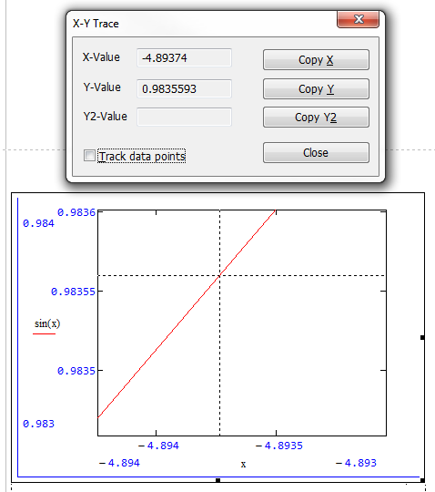

I agree with Richard that you are probably better off writing a function to give you the values you want.
However, one way round it may be to turn off Track Data Points in Trace and use Zoom to get closer to the values you want.  If you leave Track Data Points on, then Trace will skip to the default values, even if they are off the part of the plot you are looking at.   Turning Track Data Points off allows you to pick a particular point on the trace.  It's rather mandraulic, though, and will take up time and effort doing all that zooming.

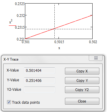

May 13, 2016
You can increase the accuracy of the trace by reducing the range plotted:

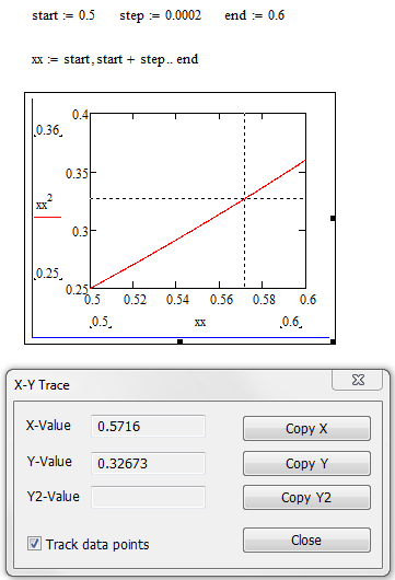

May 13, 2016
You can also specify the trace step increment by plotting over a range variable:
(X-Value trace steps in increments of 0.0002)
However, please note that I agree with the others above who are suggesting you obtain the values you want fromt he original function (or data set) that drives the graph.
