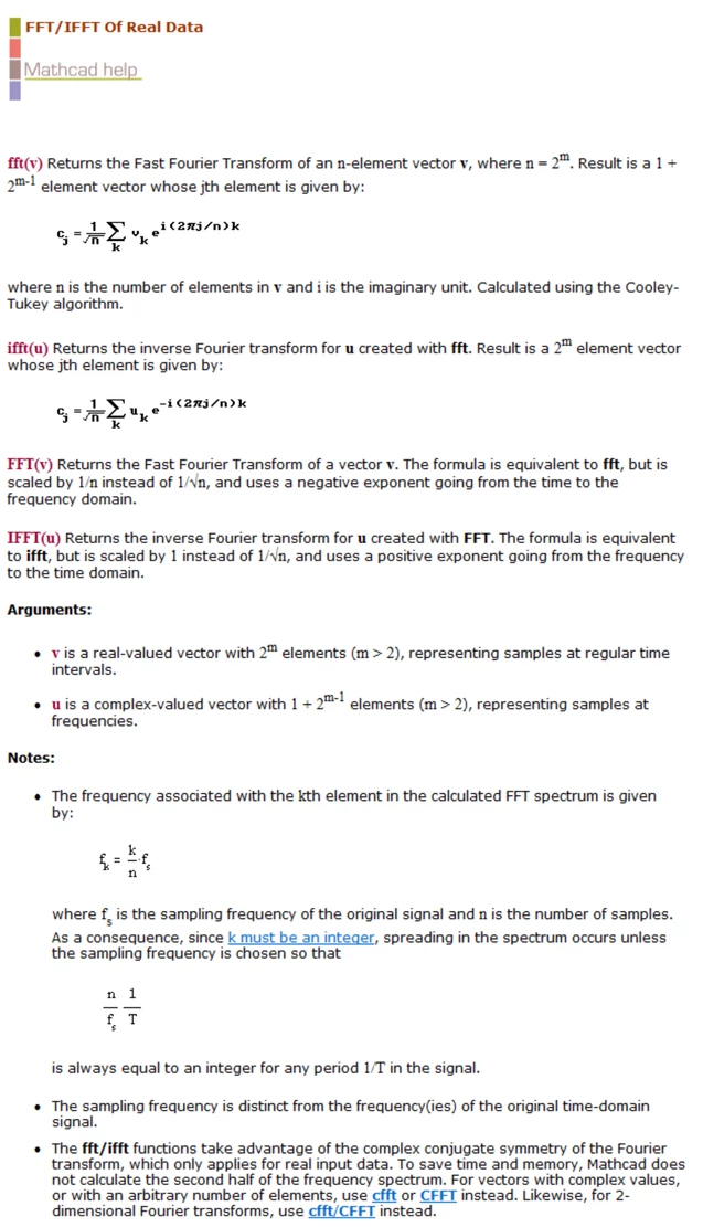

Are you using Prime or real (legacy) Mathcad (version 15,14, ...)?
In Primes help you won't find much information about "IFFT" because PTC has replaced it by "idft" and considers "IFFT" as deprecated.
Discrete Fourier Transform of Data
Maybe the original help (from MC15) can be of information to you - at least it explains The "magic number" ( a power of 2)

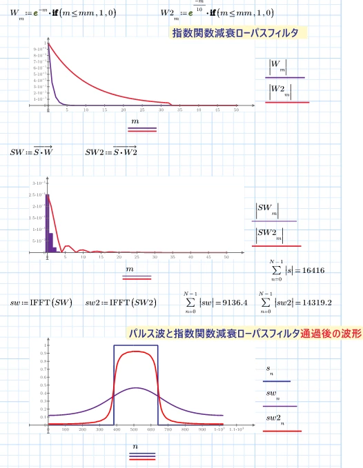

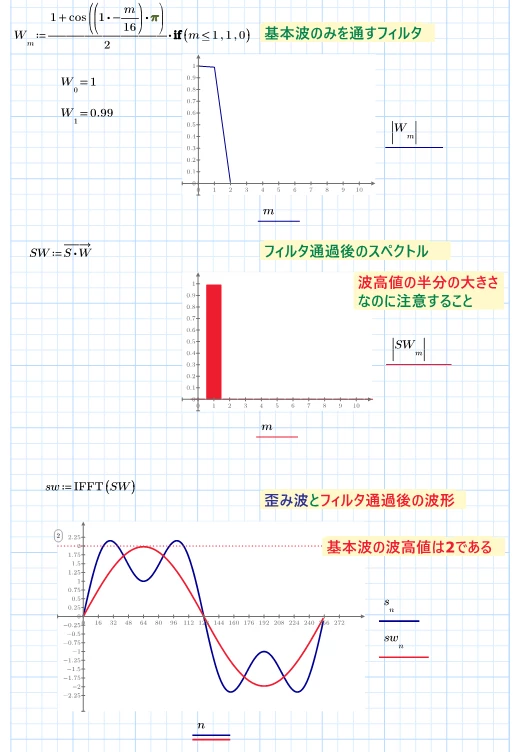

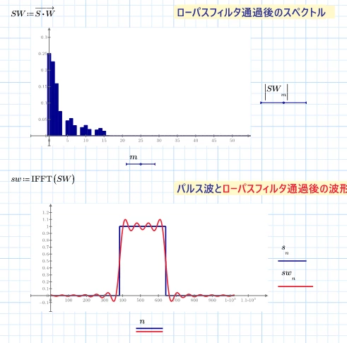

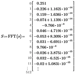

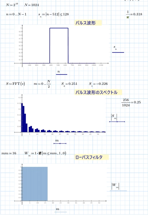

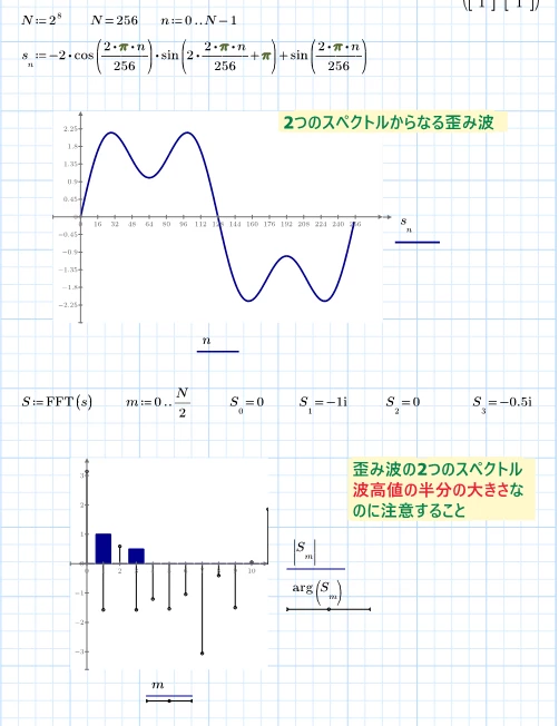

Apr 18, 2023 4:34 AM UTC
ttokoro_0-1681791992495.png..... Signal is real 1024=2^10 data.
ttokoro_1-1681792117900.png.... Its FFT is 0+512 complex data. 0: DC, 1: fundamental magnitude. Real: cos. -Imag: sin. IFFT make real signal data from the spectorums.
t.t.
