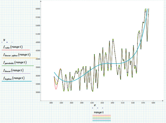

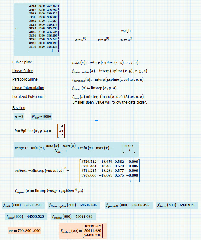

Well, you didn't attach anything, but here's some general interpolation techniques.  Be sure to plot your results to be sure the interpolation is what you want.  At the very end I calculate results for a range variable.
While more complicated, the B-spline does a nice job of fitting the data.
