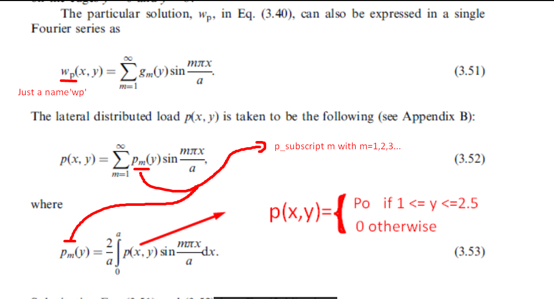

How to add a subscript m with values m=1,2,3... but also function of y
Im am trying to solve an exercise with Levy's theory for plates which is a Single Sine Series. As it is described in the books, i have to use a load pm(y) , with m=1,2,3,...M, but as a function of y. I will try to illustrate it in the following figure and also i will upload the file that I'm trying to create. It is in Mathcad 15.
I hope i'm clear enough because it is a bit difficult since i don't have it clear enough myself, unfortunately.

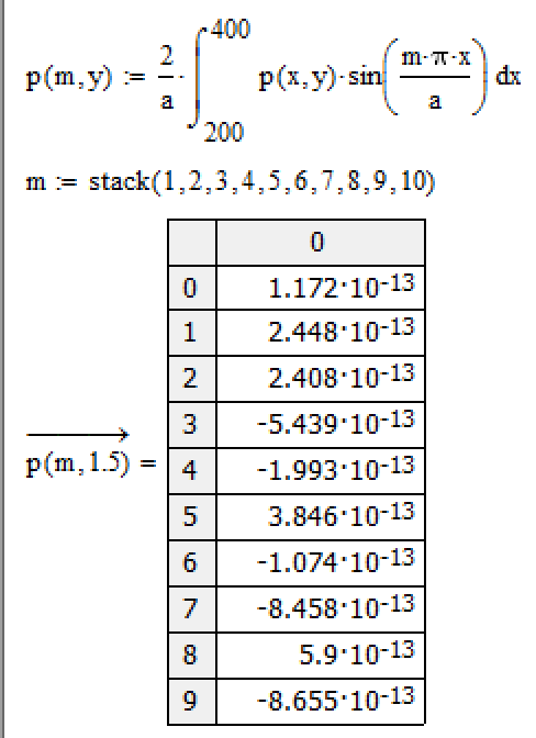

It is not a solution?
Hello Drilon,
just to elabortae on Valerys solution: as heshowed, all you have to do is to define m as a vector (single column matrix) and pass the vector elements over to your function p(m,y). The vectorize function (arrow above the function p(m,y)) ensures that the function is evaluated elementwise.
Regards
Raiko
Yeap.. it works this way. Thanks
23-Emerald I
Look at the attached sheet.
Since p(x,y) is a constant value that depends on y, it can be extracted from the integral.  That integral then has values that depend on the value of m, but it can be evaluated as a function, not an integration.
Thank you Fred..
