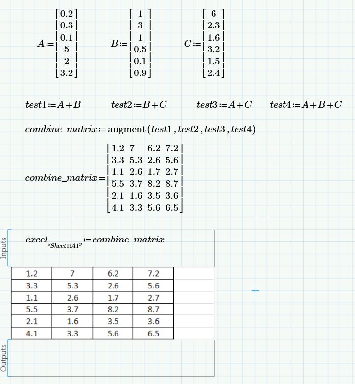

How to add one extra row in matrix or in excel component ?
Hi..
I need to add one extra row in matrix or in excel component, for more detail pls see below e.g.
In excel component it shows only values, but i want to show its heading also to understand it better as per shown in second snap (i.e. test1, test2, test3, test4).
so please can anybody help me.
Prashant Pandarkar
23-Emerald V
Aug 20, 2015 7:30 AM UTC
header:=augment("test1","test2","test3","test4")
header_matrix:=stack(header,combine_matrix)

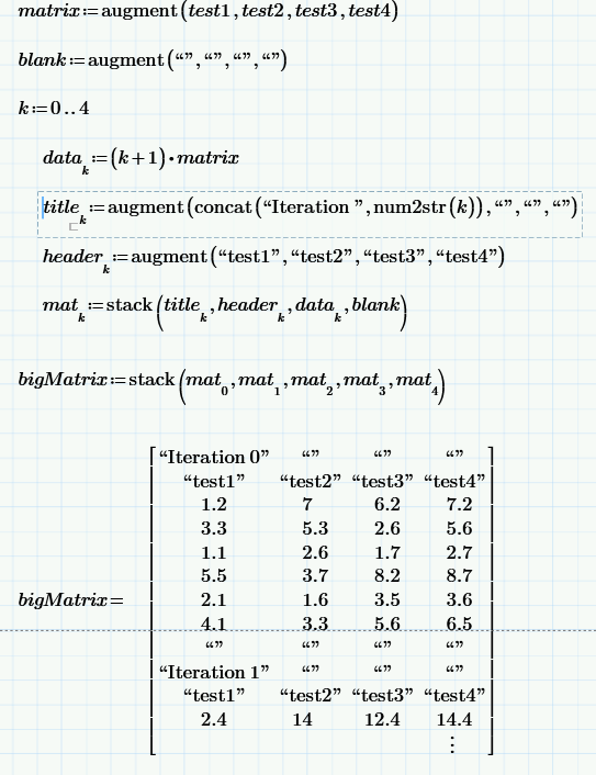

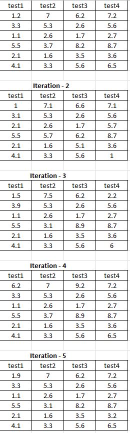

And I have one more question i.e. I want to save every output matrix in one excel.
i.e. If i change 5 times its input values, then i should get 5 output in one single excel as iteration base.

prashant pandarkar wrote:
- I
Yes, Given solution is working.
Thank you very much.
Unfortunately, I don't have Excel on my PC and I'm not familiar with the Prime Excel component, so I can't play with it to confirm how it works.  If, for example, it were possible to use a string variable in the excel component address, then it might be possible to simply adjust the write address during your iteration.
One way that should work is to construct a matrix with all of the iterations.  See below for one example - I'd use a program in practice, but this version should work in Prime Express (apart from the Excel component being available after 30 days, but the EXCELWRITE function should work).
