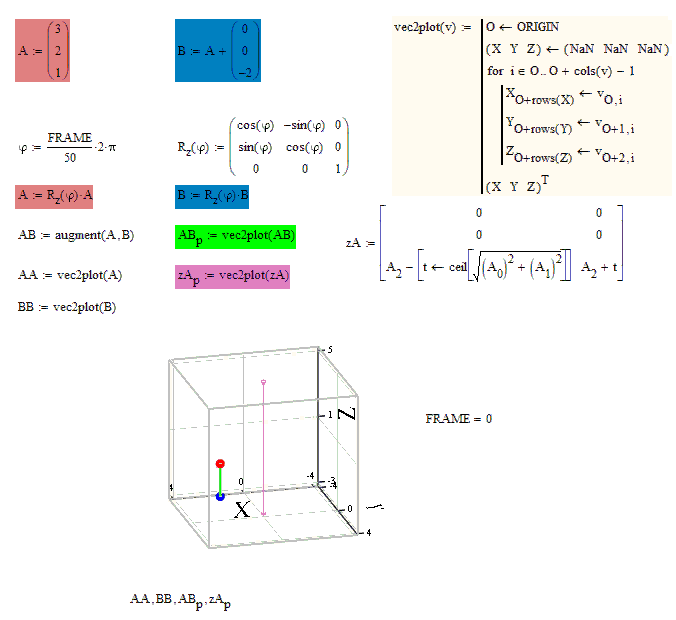

How to animate a segment in Mathcad 15 ?
Hello Everyone.
From :
To :
How to animate a segment ( green ) to rotate around Z-axis ( pink ) (Mathcad 15) ?
Thanks in advance for the time and help.
Best Regards.
Loi.

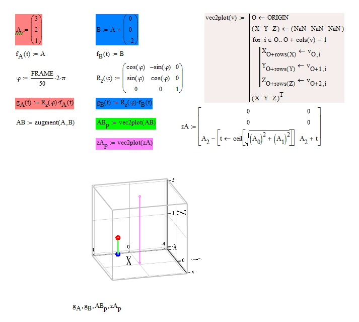

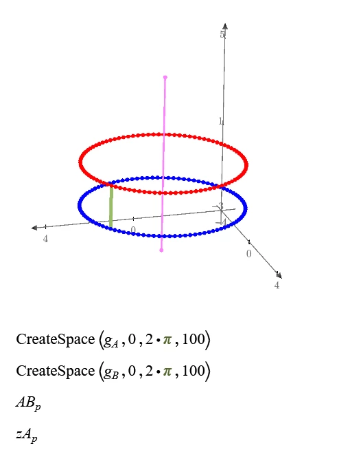

@lvl107 wrote:
Many, many thanks again, Werner. 🙄 🤔 🙄 .Especially, your explanation. But without your .xmcd file, I got stuck at several steps
?? What you did looks OK to me and it seems to work as it should, isn't it ?
Can't send the file as I did not save it.

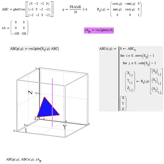

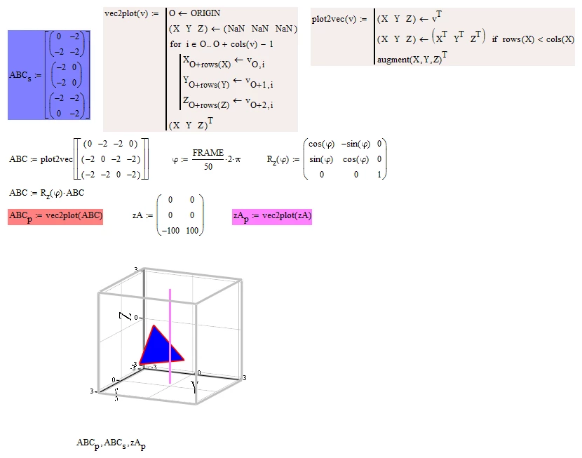

And A similar query: How to animate a Surface (blue) to rotate around Z-axis
(pink) ?
Best Regards.
Loi.

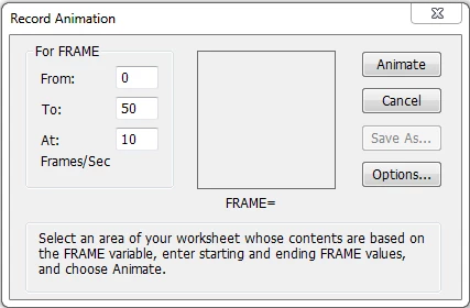

Oct 3, 2023 6:12 PM UTC
You have to put together the three coordinates of every point, rotate it and collect the results in an identical data structure.
See video in attachment - it takes this site far too long to enable embedded videos and I am too lazy to let the avi convert to an animated gif.
