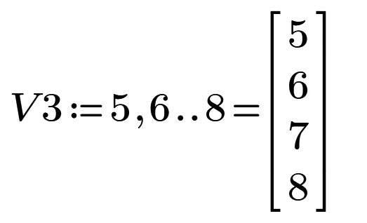

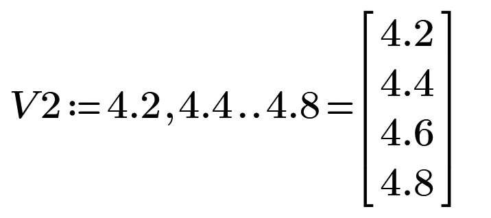

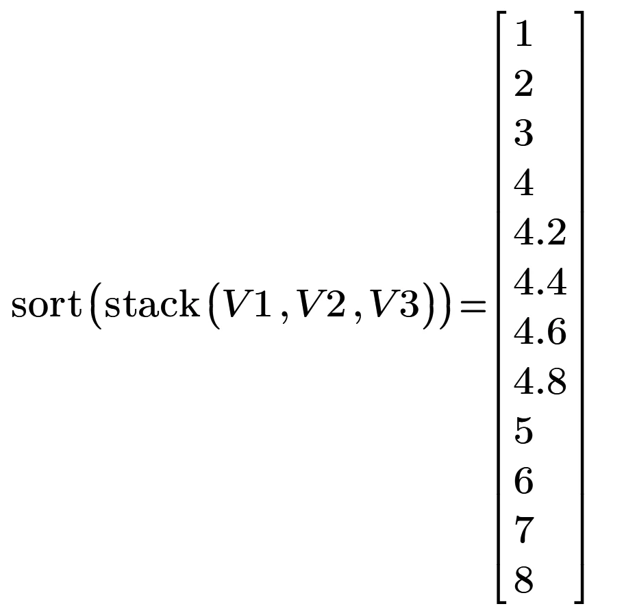

I am trying to create a vector with values like this
1, 2, 3, 4, 4.2, 4.4, 4.6, 4.8, 5, 6, 7, 8
In practice there will be many more values and it wouldn't be practical to enter them one at a time. If I create three vectors like this
v1 := 1,2..4
v2 = 4.2,.4...4.8
v3 = 5,6..8
Is there some way I can combine them into a single vector?
Also, I would like the resulting vector to be a row vector rather than a column vector (if that is possible).

ttokoro21-Topaz IAnswer
November 28, 2022
t.t.
PaulN1-VisitorAuthor
November 28, 2022
Amazing ... I would never have found that. Many thanks
