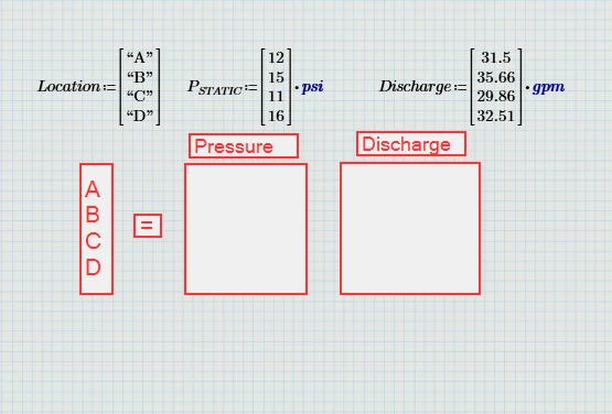

How to assemble data (matrices) for presentation
I need to add a summary at thr bottom of my calculation to shoe results as shown below.
I am not able to do.
I request shed me with some lights to get around this.

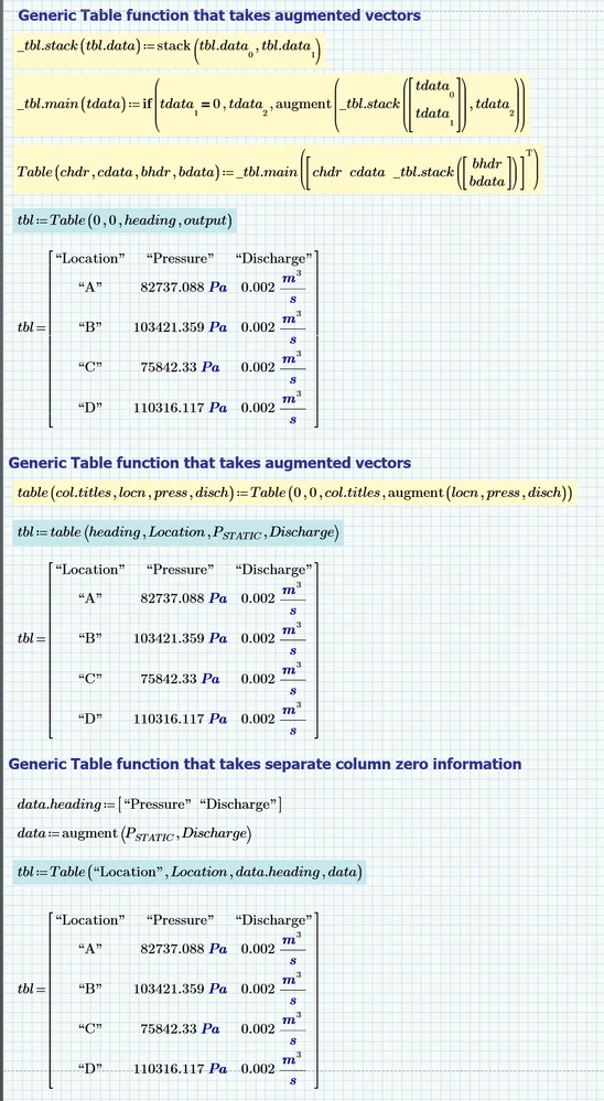

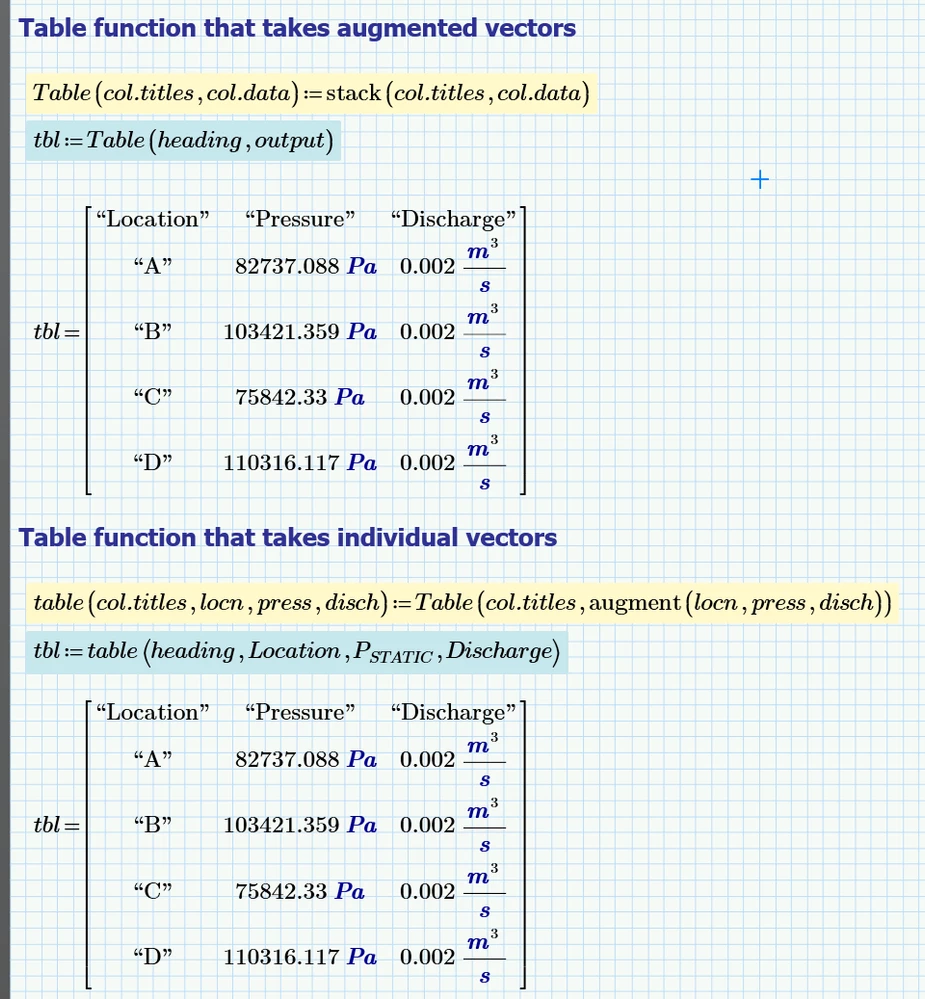

However, sometimes it is useful to have a generic function to create tables.
The last table example in the image below separates the Location from the pressure and discharge data.
Stuart
(Mathcad 10 worksheet attached)

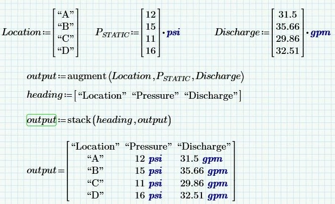

terryhendicott
One way is to create a matrix.
Cheers
Terry
Stuart

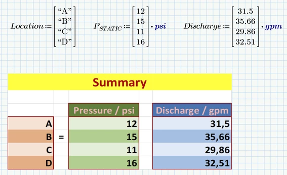

I sure would rather go with Terry's solution, but in case you need more color and other formatting features you could consider inserting an Excel component to do the job.
RWickrama10-MarbleAuthor
Thanks for the great help.
