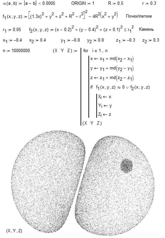

One time U have solve this problem so
ifomenko1-VisitorAuthor
December 8, 2017
Unfortunately I need to switch on "Fill surface" option under appearence tab
