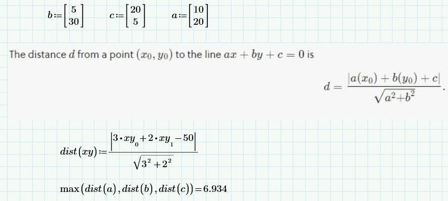

Hello friends, I am a newbie to Mathcad, could you please help me with this?
I'm trying to make a spreadsheet to determine the farthest vector from a line. Thank you

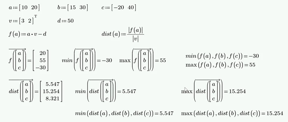

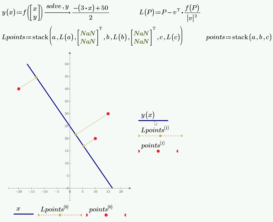

I have changed the coordinates a, b ,c into column vectors then you only need to index their position once.
Note index starts at zero by default.
Changed function to use the two elements of a vector x
Cheers
Terry

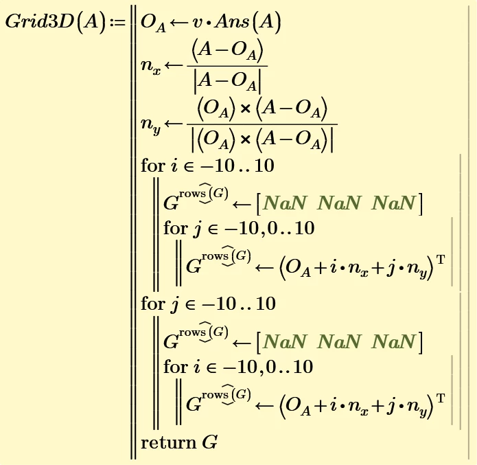

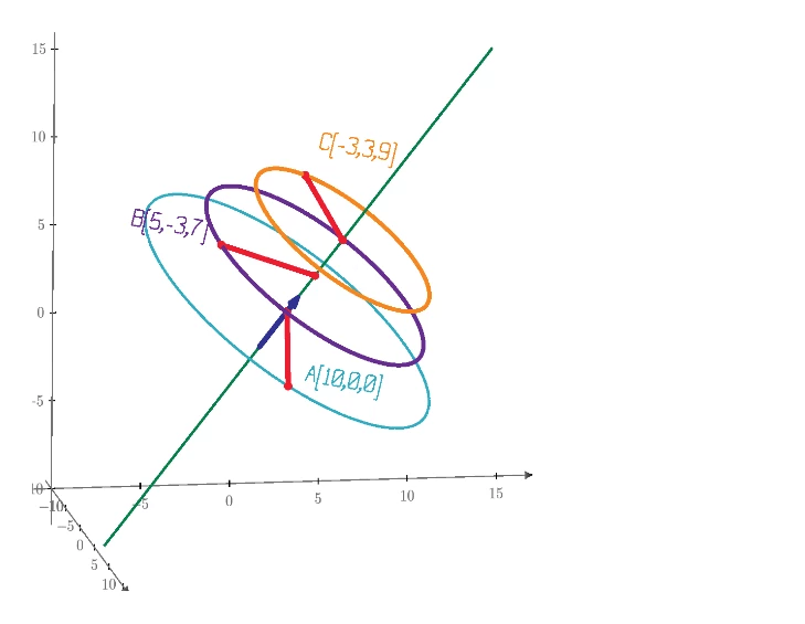

ttokoro
Sep 10, 2023 1:48 AM UTC
image.pngimage.pngimage.pngimage.pngAns=b.
t.t.
terryhendicott
Sep 10, 2023 3:37 AM UTC
Sep 10, 2023 2:03 PM UTC
In Prime a vector only is a column vector and you need just one index to specify one of its components.
row vectors are considered 1 x n matrices.
But of course you may define your points in the form of row vectors. You simply need to adopt the calculations accordingly or you could always use the transpose operator to turn a row vector into a column vector.
Here are my two cents
Prime 9 worksheet attached

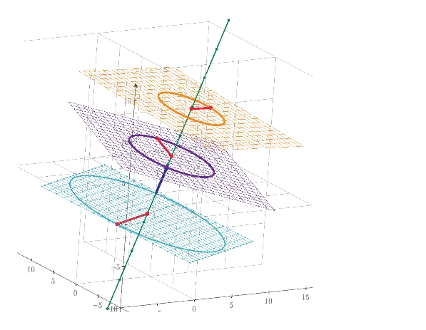

The one of 3D. Max is A.
t.t.

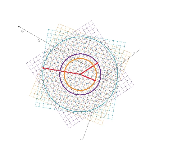

ttokoro
Sep 11, 2023 12:27 PM UTC
With grid mesh.
t.t.
