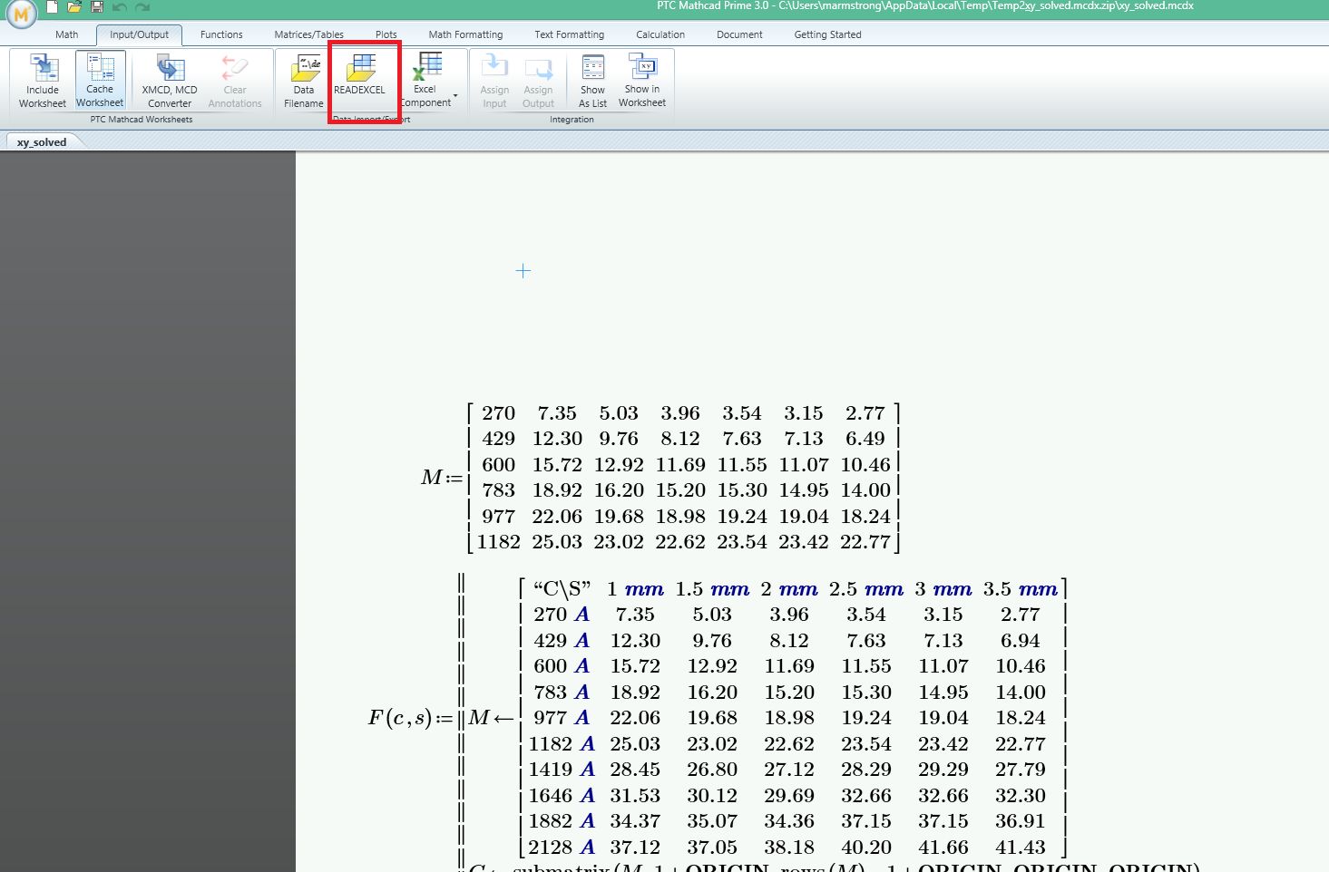

Use the READEXCEL function to bring in your data. I take it you are manually bringing it in at the moment?
Yes. The highlighted Force values were entered manually by checking in mathcad.
To automate, use the READEXCEL feature found on the Input/Output tab and specify the range of data you want to input.

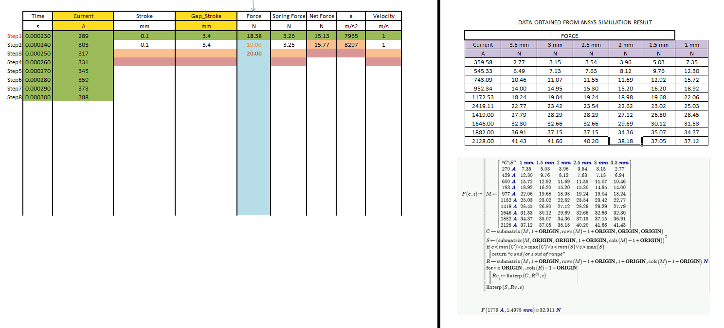

Kindly go through the description given below:
Problem description:
The table in the left side is the actual calculation that I’m doing.
The data in the right side is supporting my calculation.
The left side table values describe the performance of a coil which is fed by current (270,429,600,…) at different strokes(3.5mm,3mm,2.5mm,….) from Ansys simulation.
I need to estimate force value for any combination of current and stroke (say 280A & 3.4mm) which need to be extrapolated from the right side available data.
For that I have used the Mathcad program above which picks force value for any combination of Current and Stroke.
Coming to the Left side excel calculation, Kindly assume that Initially I know only the values highlighted in green.
The force in each step decides the stroke in the next step.
The column highlighted in Yellow ( current and stroke) in each step have to decide what will be the value of force.
Since it is not possible to manually enter the F(current,stroke) values in Mathcad for each step to check what will be the force and write it in the column highlighted in blue in left side table, I m thinking whether this can be automated like iteration process. Either by linking this Mathcad program in excel and make it run each time or reading the excel data in Mathcad and obtaining the required force values to fill the remaining steps in excel.

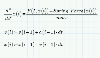

You can use a For Loop and iterate through either stroke or gap, whichever the iterative variable is. This will allow you to calculate a, velocity and inturn Stroke.
I will take Stroke as the variable.can i write an expression sometng like S(i) := S(i-1)+ V(i-1)*T directly???
Also For that I need to pick the Force value F(current, stroke) which should be F(i) for further Calculation.(Net force, Acceleration,Velocity...)

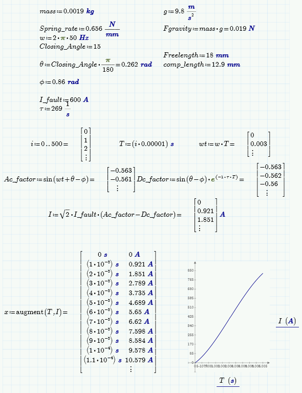

I have made some modifications...but i guess it is making a circular reference...
I tried to write the expressions for acceleration,velocity and stroke as below...
23-Emerald I
Okay;
You have a problem with your interpolation schemes, and the one in Force_recalculation just does not work.
polynomial regression fit shows how to get a polynomial fit to your data--linterp requires you to span the range of data, and when current or stroke goes outside your table it fails. (Your current will be negative some of the time!)
Force recalculation takes the third order fit of current, stroke, to force and shows the interpolation.
solenoid and spring takes the same interpolation and solves the ode for position.
I'm not sure of the correlation of x with stroke, and what to do about negative currents and forces.
Good luck!
