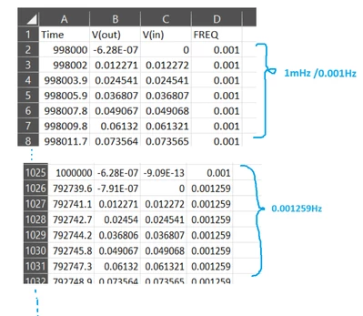

1. How can I search for each frequency range?

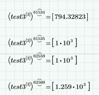

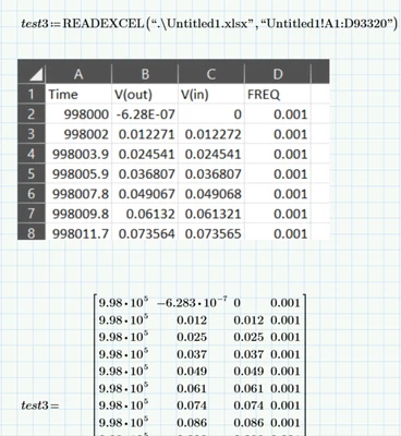

For example I looked into the excel file and I saw that 1kHz begin from line 61536 and is ended at line 62560:
Therefore I extracted manually the respective range in Mathcad:
So, for example I want to know between what range the 0.001Hz begging and ends, but without staying and looking into excel file, some automatic routine if can be made in Mathcad:

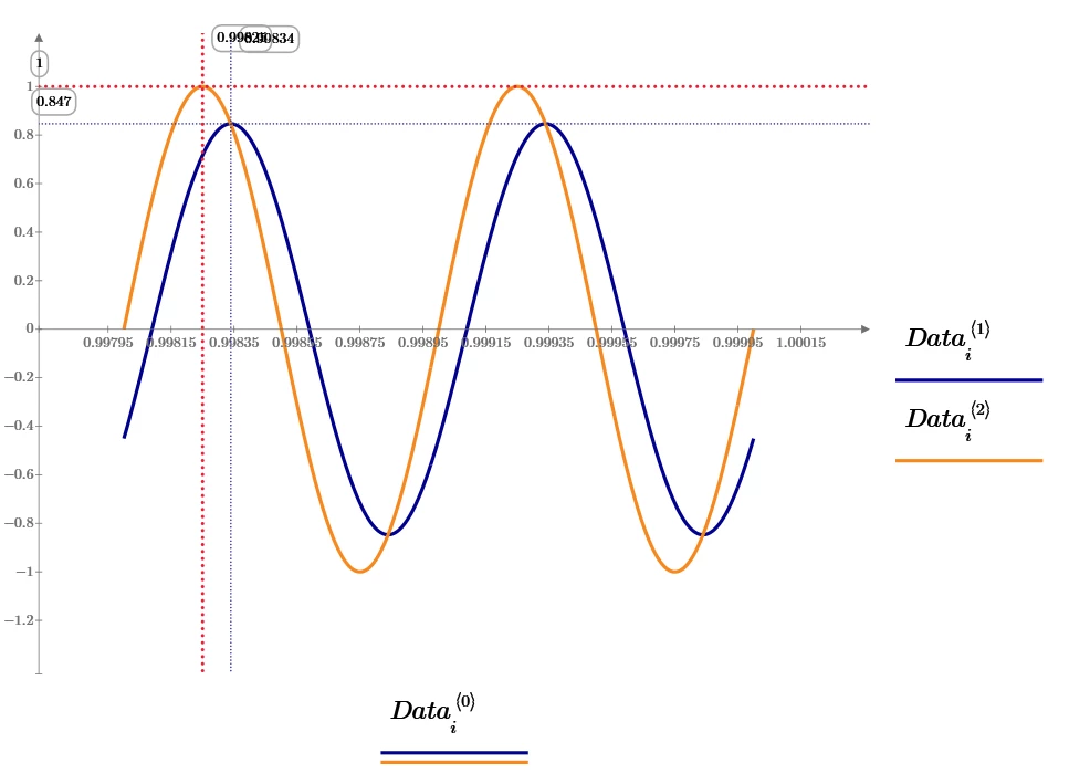

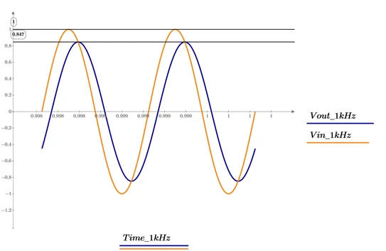

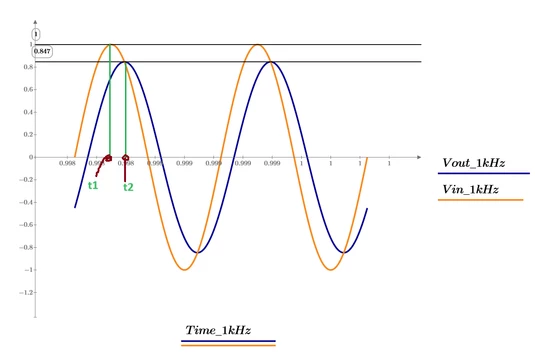

And then I want to know the maximum value for Vout and Vin at the respective Frequency and at which time these maximum values are occuring:
Above its only the maximum value at 1kHz, but I do not know at what time these maximum values for Vout and Vin are occuring.
Because I want to know then the difference between t2-t1.

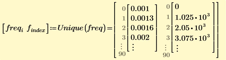

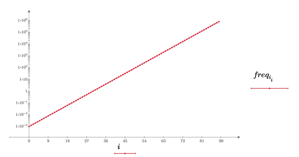

ttokoroAnswer

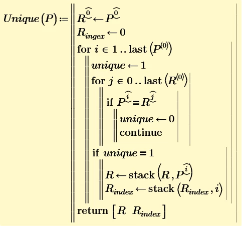

Using modified Werner_E's Unuque function.

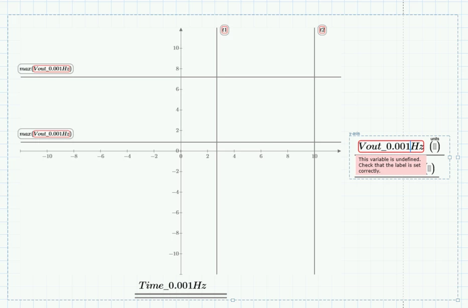

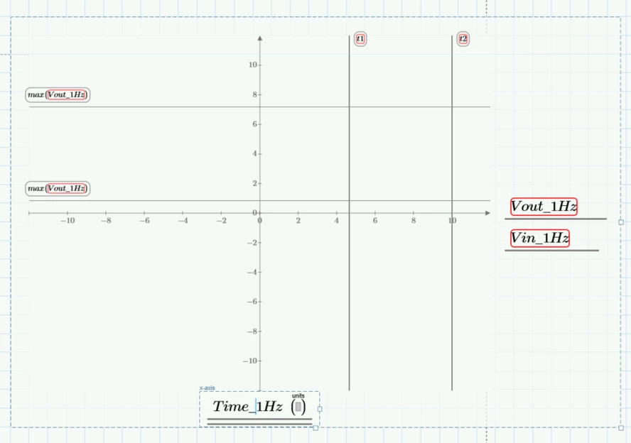

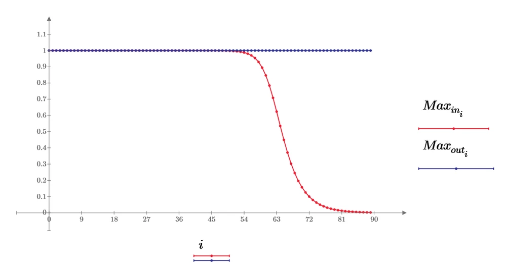

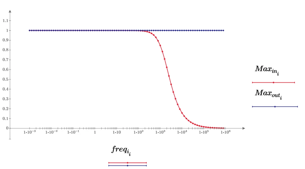

And these two things I want to know:
1. The maximum value for Vout and Vin at each frequency range
2. The time values t2 and t1 when maximum Vout and maximum Vin are occuring for each frequency range
For each frequency range:
and so on..

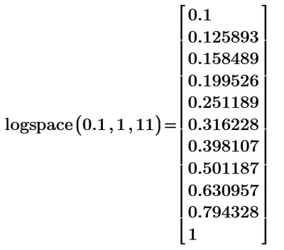

The spacing between frequencies:
From 0.001Hz to 0.01Hz:
From 0.01Hz to 0.1Hz:
and so on...till 1e6Hz
Cornel19-TanzaniteAuthor
From 0.1Hz to 1Hz:
