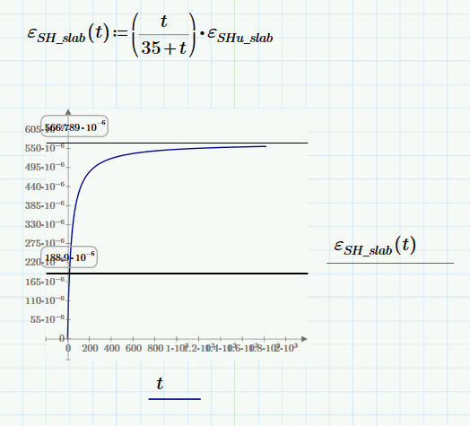

I have a specified function. However, I want to be able to find both values at an specific intersection. Is there a prime command to do this? are markers able to give you values in both axes or only 1 axis at a time? example provided below.
8-Gravel
September 18, 2016
Untitled.pngI want to be able to find the value of t when esht=188.9*10-6 for example. How?
September 18, 2016
Like this:
