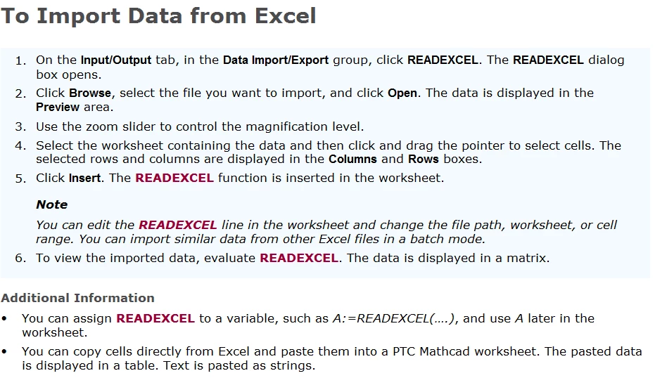

From Prime 3.0 help:

Fred,
Following the steps above, for the READEXCEL command allows data to be read from an Excel file located in the directory specified.  The data is not bound or saved within the Mathcad File.  So I can locate my file in one location and read from there, but once I send my Mathcad file in an email to some one else, the table values will be lost.

The READEXCEL function will allow you to specify the complete path--you do not have to have the files in the same folder.
