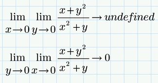

I was thinking that this is done in this way, but I was wondering if exists a more compact way of calculate such kind of limits of multivariable function, like in the manner I shown above, writing one single limit operator (because if my function has 4,5,6, etc variables then I need to write 4,5,6 limit operator)
Jul 28, 2023 7:25 AM UTC
If there would be a "more compact" way, then this way would have to offer an option to define the order.
As you can see below, the order may matter

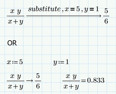

Of course in your example using "lim" does not make sense as you could as well use substitute or define the variables
