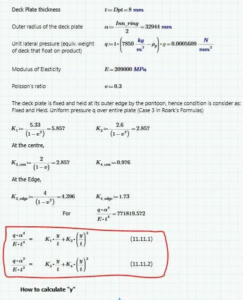

Please attach your Prime worksheet, not just a picture! (And please state which version of Prime you are using).
Don't start new threads for the same question, you can answer in the same thread.
23-Emerald V
Jan 8, 2020 9:18 AM UTC
Other than that, the answer is found by:
Most probably it is:
or, in Prime Express, and numerically:

thank you
