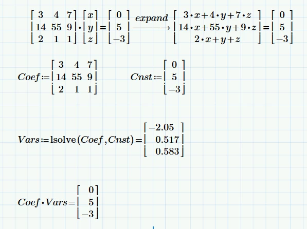

I'm afraid neither Mathcad nor Prime offers an automatism for this.
Note that you can write the set also as a multiplication of a 3x3 matrix with a 3x1 vector containing x, y and z that equals a 3x1 vector of constants...

What Luc is talking about is Matrix representations:

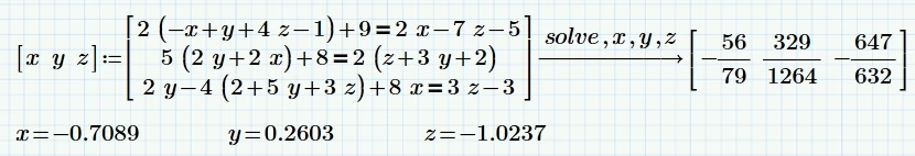

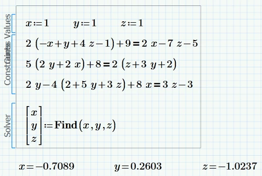

But of course Mathcad/Prime is able to solve the system just the way you had it written. You may use either the symbolics
or a numeric solve block to do so

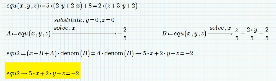

Here is a (clumsy and awkward) way to achieve what you had demanded which does its job without manual copy and paste, etc. Its not perfect and will fail if the variable you solve for (in my example x) does not exist in the equation.
I was just curious if it would be possible at all to achieve what you asked for and to some extent it is. But I am pretty sure its not worth the effort:
 BTW, solving for x ensures that the coefficient of x on the LHS is always positive.
If you are concerned as of the red errors which stem from the numeric engine, you may either replace "equ" by "equ(x,y,z)" or add a symbolic evaluation when you define the equation (as shown below with equ2):

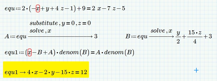

And then there is:LM_20180105_Collect.png
Where the expression at the bottom comes close(st) to what you want.

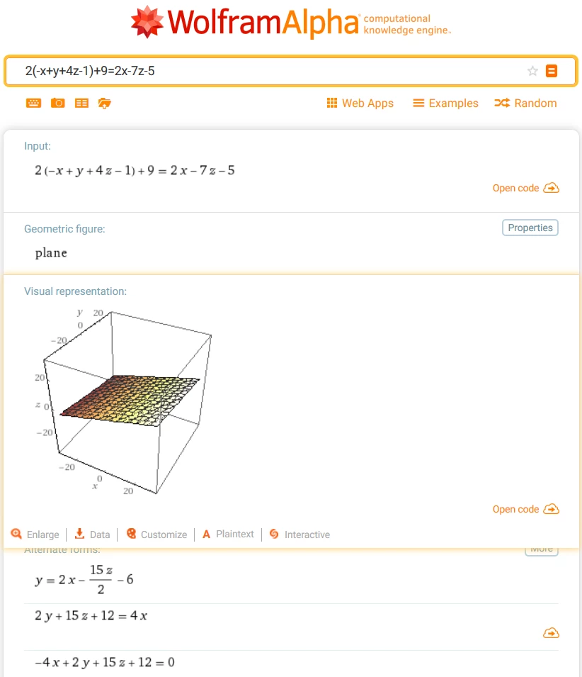

I am not sure if using other software is an option (you may consider using the "simplify" command in WolframAlpha). In fact we don't even know if Gilgamesh is using Prime or real Mathcad (15 or below). In Mathcad we could turn the steps I showed above into a convenient function - in Prime thats not possible.

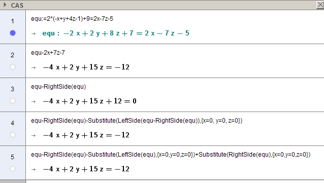

If other software is an option, there are a lot of better alternatives. If it should be free, Maxima or Geogebra come to mind. They all are capable of manipulating (manually or automatically) equations better than Mathcads/Primes symbolics.
Here is an example with a few ways done with Geogebra (we could create a user defined command("tool") to do the dirty work in the background):
