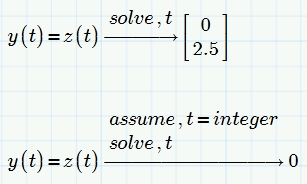

Sometime (while not often) the symbolic "assume, t=integer" helps as here with Andy's example
But unlike Mathcad 15 and below you can't combine symbolic evaluation with a solve block in Prime. So this may not be an option either.
