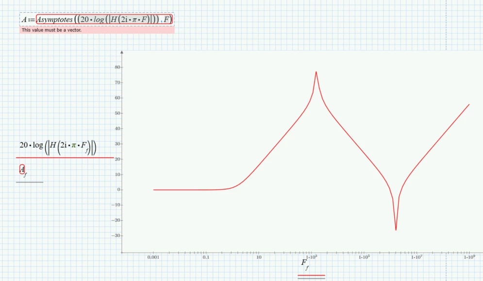

How can I draw the ASYMPTOTIC bode plot of this function in more automatical way? Is it possible? I mean I know that this asymptotic bode plot can be draw after some manual analysis, but is it possible to make a program that can draw automatically this thing?
I am expecting something like that (red plot):

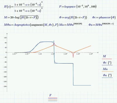

So, after some fumbling I was able to improve the automatic asymptote generation for bode plots.
The function should work fine for most real-world examples of filters,
as an example:
or, another example:

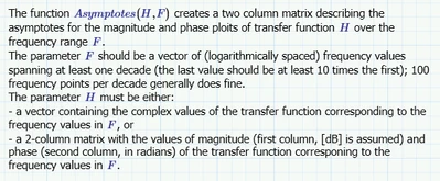

The option to supply H as a 2-column vector should work well if you import data from a circuit simulation program (Spice) to plot.
See attached file, which also works in Prime express. (Yes, all it took was a one-liner.)

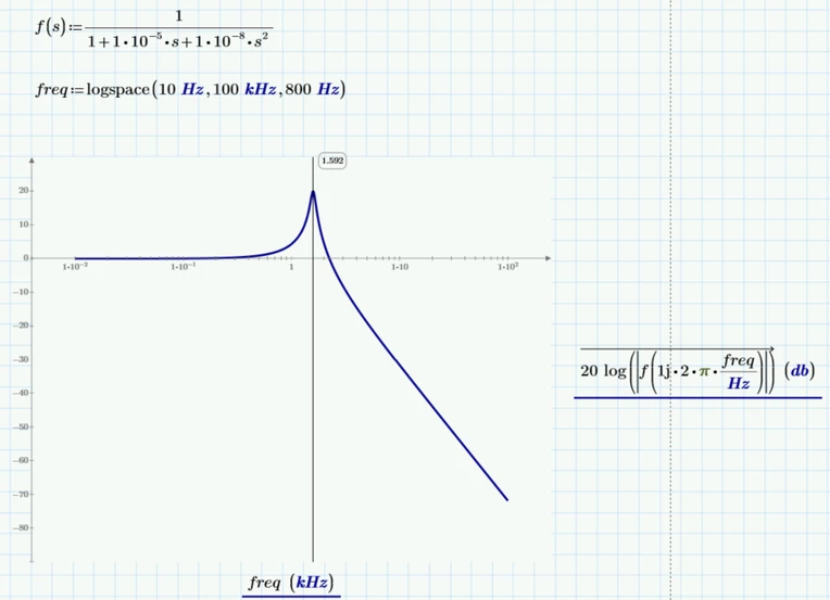

BTW, the third argument of the "logspace" function is dimensionless, its the number of entries created. I wonder why Prime does not throw an error when you chose 800 Hz as argument but rather seems to simply ignore the unit.

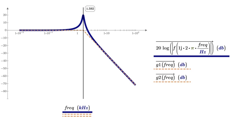

Here is a bold attempt done with Mathcad. Sure not generic and not a 1-button-push solution.
You may use it as a starting point for your own attempts.
Prime 10 sheet attached

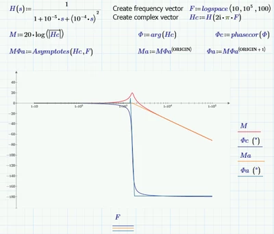

I've had another look at it and....How's this:
Or, for another
this:
I should like to see the translation to Prime...

Hm
Or if we put like this, the error is this:
ttokoro
Jul 8, 2024 8:24 AM UTC
Just change logspace from function to variable, i. e. the program function Luc made.
