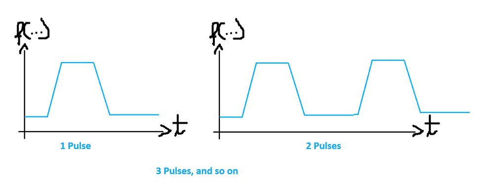

How to construct in Mathcad this kind of pulse signal with these characteristics?
How could be made this kind of pulse signal in Mathcad?

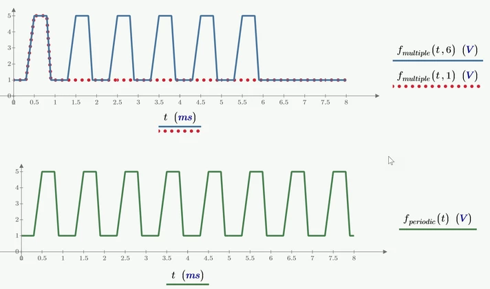

And I want to be able to select how many pulses to be displayed if possible:
Jun 14, 2024 4:59 PM UTC
Here you are, but please don't ask for the Fourier transform of those signals! 😉
Prime 10 sheet attached

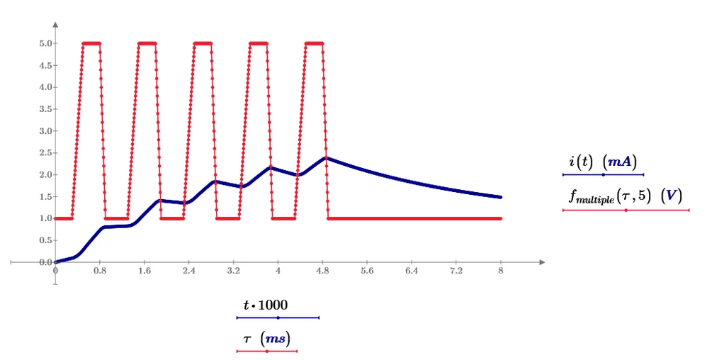

ttokoro
Jun 14, 2024 11:43 PM UTC
RL circuit. R=1 kohm, L=3 H.
t.t.

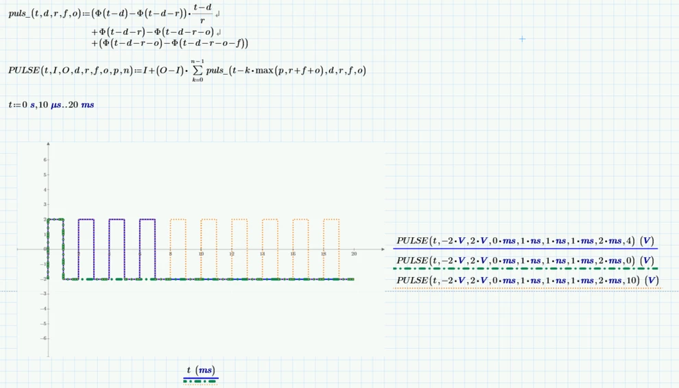

LucMeekes23-Emerald VAnswer
23-Emerald V
Jun 16, 2024 8:14 PM UTC
Dug up an old file, see attached.
You could try out what remains of it when you translate to Prime.
Cornel19-TanzaniteAuthor
Jun 19, 2024 7:48 AM UTC
Luc, I see something in the PULSE signal: in description is said that if n=0 then should I see pulses on the entire range definition of time t (something like orange), right?
Can have a look?
23-Emerald V
Jun 19, 2024 8:08 AM UTC
It's a wish that didn't come true...yet.
