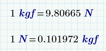

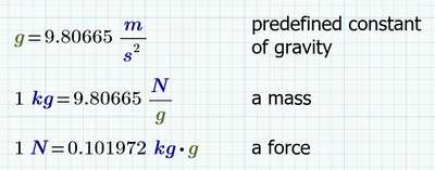

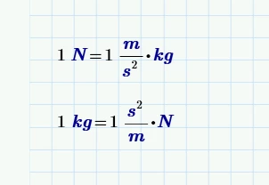

You were already told that this is nonsense! 1 kilogram IS NOT 9.81 Newton!! MASS IS NOT FORCE!
You are confusing kilogram (dimension: mass) with kilogram-force (dimension: force) which also was called Kilopond.
https://en.wikipedia.org/wiki/Kilogram-force

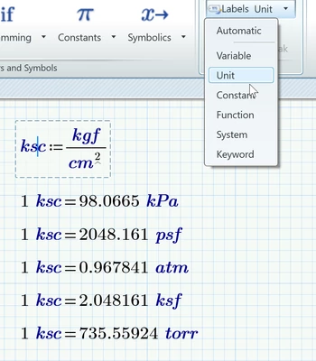

"kgf" is a unit for force which is also pre-defined in Prime

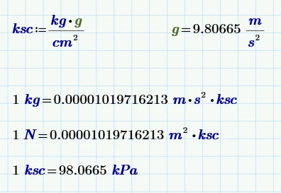

According the unit "ksc" - its defined as Kilogram-force per square centimeter.
https://en.wikipedia.org/wiki/Kilogram-force_per_square_centimetre
This unit is NOT predefined in Prime, but if you need a pressure unit which is not predefined
you always can define your own units. I would suggest doing so at the top of the sheet in a collapsed area and not using the global assignment.
When you define a new unit, you should also label it as "unit" for consistency.

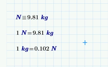

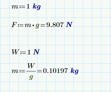

Your statement in the black box is wrong. N does not equal kg. This is physical nonsense, as mass does not equal force. In you equation is Earth's acceleration "hidden", therefore you have "1 kg = 9.81 N"
8-Gravel
Apr 11, 2023 6:54 AM UTC
And how to make the MathCAT know that 1 kilogram is equal to 9.81 Newton?
Is it correct?
Or is there any other way?

maybe you need this:
