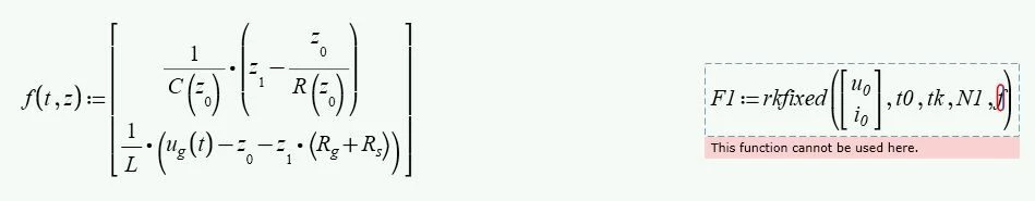

Enclosed is converted file to Prime 7.
There is a problem with rkfixed function used in the Prime worksheet.

January 16, 2022
