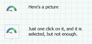

Just a shot in the dark: There are at least two different ways to select a region/image: "Left Click" and "Ctrl & Left click". The latter has the same effect as if you were fencing the region (it gets blue).
I tried both ways in Prime 6 and Ctrl-C and then Ctrl-V would work both fine, but maybe Prime 7 is different in that way.
