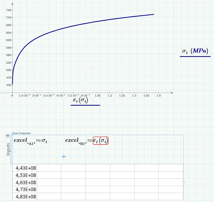

This question is for Mathcad Prime 4.0. I have a sheet caluclating and plotting the true stress-strain of various materials. Now, I want to copy these values into a FEA software. To me, it looks like you cannot copy directly from variables and functions, so I figured I try to put in the data in an embedded excel sheet and copy from there. However, I ran into problems here as well.
I've figured out how to write the stress values (sigma_t) to excel. How can I write the values of the strain (epsilon_t) into column B?

You have to make sure that the what you supply to the "Excell" objects, are vectors (maybe matrices).
In the attached example (Prime4), you should be able to export both s and F, but not f(s).
