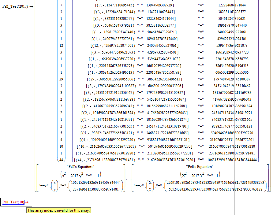

Hello Everyone,
How to correct the Pell(n) function ? ( for n = 181)
Thanks in advance for your time and help.
Regards.
Werner_EAnswer
January 4, 2015
For some N (like 2,5,10) m is just 1 (second element of C is already greater than the root of N) and so your calculation of the rearranged vector c fails. Either include another if-statement to cope with that case (then c<--C) or do it completely different like in the attached.

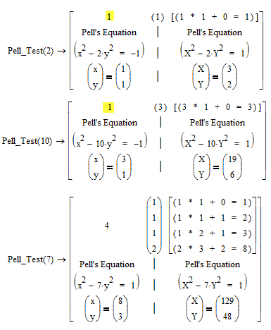

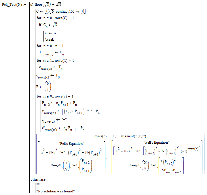

Hello Everyone again,
Now I need help with correcting the Pell_Test(N) function, the above. ("This array index is invalid for this array")
Best Regards.
Werner_E25-Diamond IAnswer
January 4, 2015
lvl10720-TurquoiseAuthor
20-Turquoise
January 4, 2015
I greatly appreciate your help. The answer is very neat . Many, many thanks, Werner.
